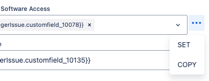

Unless you are doing complex things in your rule, You can, in your Edit Issue screen, select this field and. .when you click the 3 dots by the ellipsis (highlighted yellow), you can choose to copy from Trigger issue. Like below:
As said, sometimes you may have to do this using Advanced Edit but depends on the use case so please share your rule so we can help. Thanks!

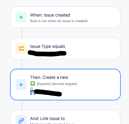

Here is my Automation started.
Then in the "Create a new"
As you can see the 3 dots doesn't have the options as in your screenshot.

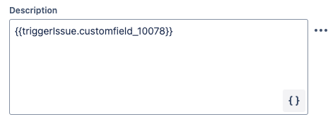

I checked in JSON view of the Trigger ticket, the customfield_# is correct, and when I put that in Descriptions,
Then the selected options will be showing in the Ticket B's description separated by commas.

Hello @ali
Once you select "Copy", it will open up options in the main screen and you need to choose "Issue to copy value from" = Trigger Issue and, "Field to Copy" = your checkbox field..
