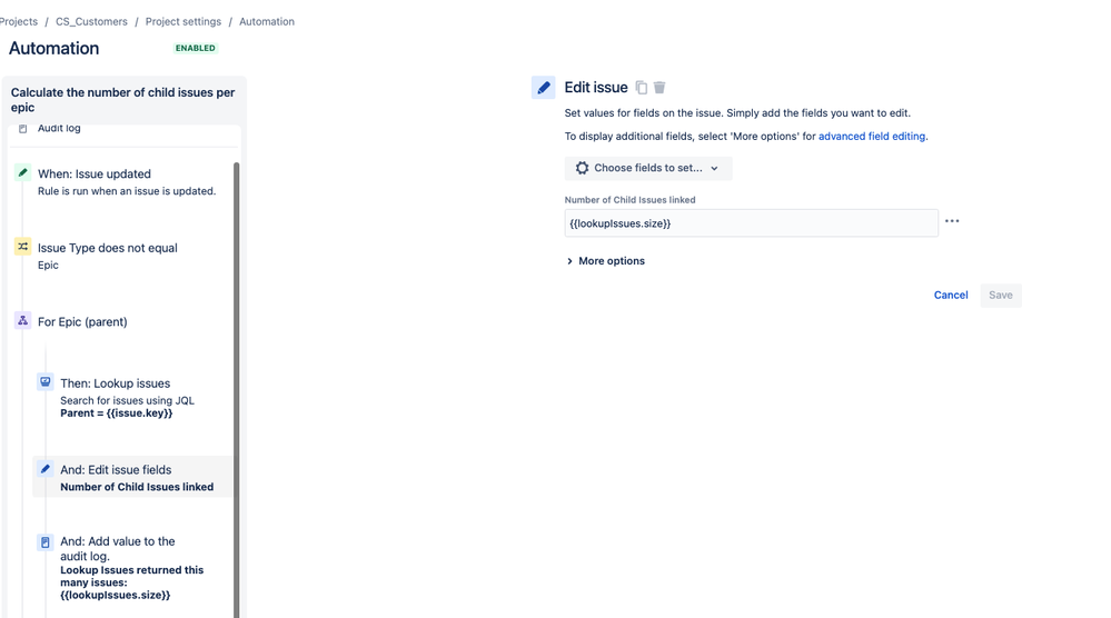

Hi @Trudy P Claspill thank you for your reply! I changed the Edit action to use {{lookupIssues.size}}.
I've been doing some research on the Log Action, but I can't figure out what I need to write as the log message :/ I'm new to the game. Do you have any tips?

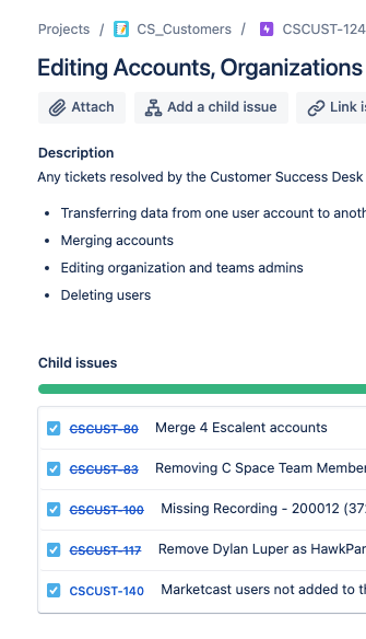

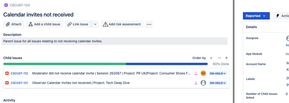

Here's what the Epic looks like:
You can see that to the right I have a field to display the number of child issues, which should be 2, but it's 0.

For Log Action you can put in plain text and/or smart values. So, for instance, after the Lookup Issues action you could use a Log action to print out the size of the results set:
Lookup Issues returned this many issues: {{lookupIssues.size}}
You can use the Log action to print out any smart value to check that the value contains what you expect.
Can you show us the output of the Audit Log for the rule when it executes? Click on Audit Log above the rule steps. That will show you the logs for each configuration change and execution of the rule. You can click on the Show more to the right of an entry to get more details.
Looking at the rule details you provided and the image of the Epic with child issues I see a problem. In the Epic it looks like the child issues might all be Bugs based on their icon. In the rule you have a condition to check that the issue that triggered the rule (the issue that was changed) is a Task. As this Epic doesn't appear to have any Task child issues, the rule will not update this Epic.

Thank you so much for your reply! Your comment is correct, I sent you a picture of only bugs when the rule was meant for tasks by mistake.
The audit log came back as zero again :/ and ticket 124 has 5 child tickets linked.

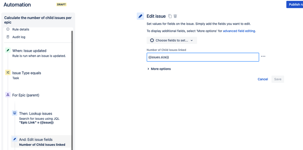

Make liberal use of the Log Action to print out to the rule execution audit log any smart values that you are trying to use in your rule to make sure they have the values you expect.
After starting the branch For Epic and before the action to Lookup Issues, add a Log action and print out the smart value {{issue}}. You are trying to use that in your Lookup Issue JQL. Make sure that it has the value you expect.
I think you action need to be using {{issue.key}} there instead.

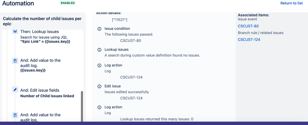

@tru thank you for the advice, I was able to add a Log Action where you said and it's returning the value as expected, but the rule still says that the {{lookupIssues.size}} is zero... this is so frustrating :( I don't get why it's not working...

Trudy P Claspill
March 30, 2023
You should use the singular, not plural, issue
Use {{issue.key}} not {issues.key}}
If you go to the Advanced Issue Search screen and enter the JQL that you use in the Lookup, substituting the actual Epic issue key for the smart value, do you get a set of child issues?
Are these issues in a Company Managed project or a Team Managed project? That information will display at the bottom of the navigation panel on the left when you view the project.
The Epic Link field is used only in Company Managed projects. If these issues are in a Team Managed project then you need to use the Parent field instead
Parent = {{issue.key}}

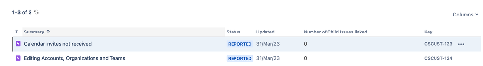

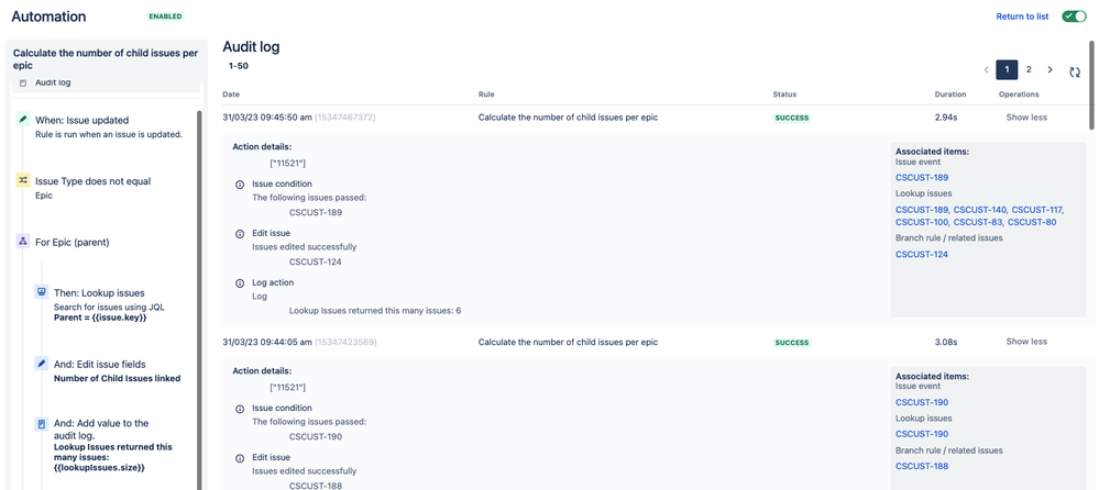

Hi Trudy, we've made progress!!
By switching the {{issue.key}} to {issues.key}} the audit log will now return the real values!! However... I've tried testing multiple times and the automation still prints "0" in the "number of child issues linked" field.
See below #124 that should have 6 child issues:
I feel that we are getting so close! Thank you for your help so far, just need to figure out why the field is still showing zero when I have this...:
Additionally, this is a team-managed project and I've also tried changing the "For Parent" branch, but the automation doesn't work, it says the issues don't match the condition and no actions are performed.

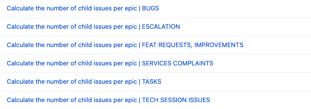

I had to change the "Issue Type does not equal to Epic" to "Issue Type equals to Task" and copy past the rule for all my other issue types, i.e. I had to create 6 different rules, each with different "issue types equals" condition.

Trudy P Claspill
March 31, 2023

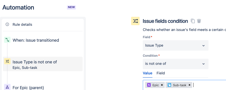

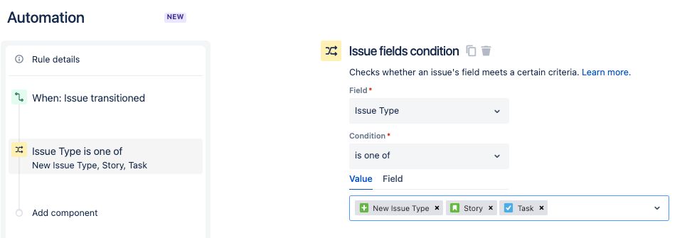

With the condition being
Issue Type is not equal to Epic
...your rule may have been getting triggered by a transition for a Subtask. That would explain the problem with the issue count from LookUp issues.
If so you can still use just one rule and include all the child issue types in your condition like this
Or set the condition to exclude Epics and Subtasks like this

carolina
March 31, 2023
Hi Trudy, I did try that but it didn't work. Ultimately the only thing that did work was splitting all the issue types :/
