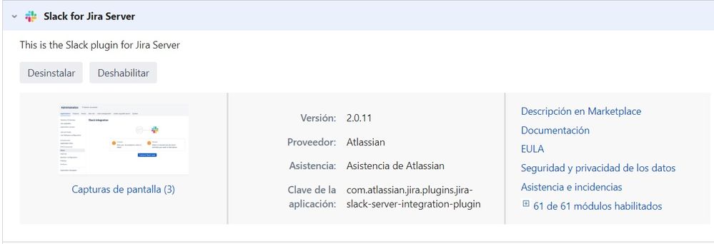

Given that there are a few Slack connectors for Jira Server, can you confirm which one you've got installed? A screenshot of the app in the Manage Apps page in Jira would be helpful (unless you know for sure which one it is already).

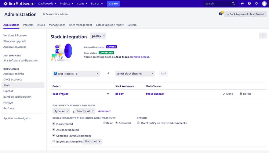

For the Atlassian-provided app, there's a per-project configuration screen. Would you be able to take a screenshot of that screen for the project/configuration that's giving you trouble? Here's an example:

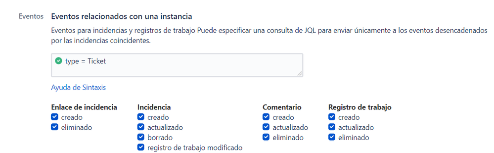

Hi Daniel, thanks for you reply.
I'm attaching the screenshots of both the Slack app version and the Slack webhook events configuration.
We are not using the App since our Jira Server is in a restricted environment (own domain) behind a firewall, however this is not a problem, as we are receiving notificactions for all issues transitions, events and changes, the only notification that is not arriving is the one when New issues are created.

Based on your screenshot I conclude that you configured a webhook, not a Slack plugin. You can configure Slack plugin by going to Administration -> Applications -> Slack. Find more information on Slack plugin configuration and usage on our documentation page.

Yes, we are using a webhook since our Jira Server is behind a firewall, as the Atlassian documentation reccomends to use.
In any case, it should notify us when new issues are being created (as per the webhook configuration screenshot shows, you can check/uncheck that specifically), but it does not.
