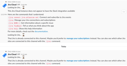

Toby Moore
January 11, 2019
Hi there, thanks for the response.
Yeh I can confirm im both a slack and jira admin. I believe we have the jira cloud plugin installed as you can see from the below screenshot.
Either way I have made sure that the jira cloud plugin from you link is connected, I ran the '/jira connect' command which shows me that it was already connected and then created an issue to no avail!
Toby Moore
January 14, 2019
@Petter Gonçalves also when you post a link to a jira ticket in the slack channel slack is able to go off and get information about it and post the issue type, status etc.

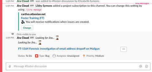

Libby Symons
October 4, 2019
@Petter Gonçalves Resolution for this? Experiencing the same issue.
Hoping for response. Thanks!
