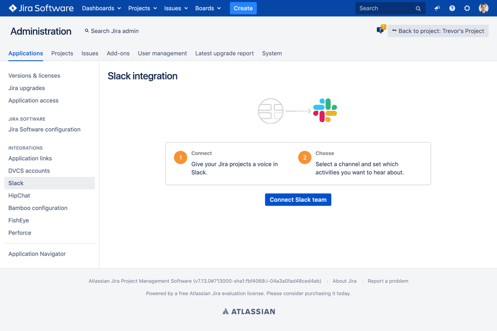

If you've only got one Jira Server instance to connect to your Slack workspace, the good news is that you don't need to go through the manual configuration process for creating a new Slack app. Clicking the blue "Connect Slack team" button in Jira administration will walk you through configuring Jira with a pre-built Slack app.
image2019-2-14_13-25-8
