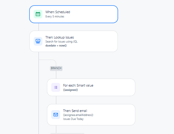

mohit jangid
November 4, 2024
Thankyou, I want to understand it thoroughly like how can i restrict individual assignee to get the mail only when there is no overdue issue. and is there any way we can do this via automation

mohit jangid
November 4, 2024
The subscription part is pretty much clear to me but I want to create an automation for this to understand the other side as well and then i can conclude which one i go with.

Fazila Ashraf
November 4, 2024
@mohit jangid , I think you misunderstood the branching statement as 'For each assignee'. It would actually interpret as 'For each issues, assignee variable = smart value'.
I do not see a way how you can achieve a single email for each assignee on all their due issues through automation.
