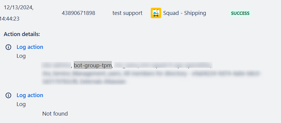

I’ve thoroughly read all the documentation provided, but I still can’t resolve this issue, nor do I know how to control the results from the API call.
In the meantime, Atlassian support suggested another approach: using a smart value to retrieve the list of the reporter's groups {{reporter.groups}} and then searching for the value I need within that list. I can retrieve the list, but I can’t filter it to extract only the group I’m interested in. Here’s the smart value I’m using:
First log action:
{{reporter.groups}}
Second log action:
{{#if(not(reporter.groups.isEmpty))}}
{{#forEach(reporter.groups)}}
{{#if(equals("bot-group-tpm", .))}}
Found group: {{.}}
{{/if}}
{{/forEach}}
{{else}}
Not found
{{/if}}
And here’s the result:2024-12-13_14h45_01.png

Bill Sheboy
December 13, 2024
Thanks, I just learned something new: the user smart value now provides "groups".
Let's modify the approach I described earlier to use that information...

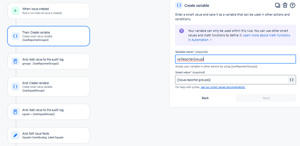

Testing indicates the groups smart value appears to be one of the dynamic smart values, which is found just-in-time when it is used.  And so to query it, the values must be saved as text first.
  • action: create variable
    • name: varReporterGroups
    • smart value: {{issue.reporter.groups}}
  • if you wanted to test for the "bot-group-tpm" group
    • smart values condition:
      • first value: {{varReporterGroups.split(", ").match("(bot-group-tpm)")}}
      • condition: equals
      • second value: bot-group-tpm
Assuming your Squads all have group names matching a pattern, such as "bot-group-ABCD", you could still use the lookup table approach:

Step 1:
Trigger
Step 2:
Create variable:
variable: varReporterGroups
Smart value: {{isue.reporter.groups}}
Step 3:
Create variable:
variable: varSquadGroup
Smart value: {{varReporterGroups.split(", ").match("(bot-squad-,++)")}}
Step 4:
Edit issue:
My_Customfield: {{varSquadGroup}}
