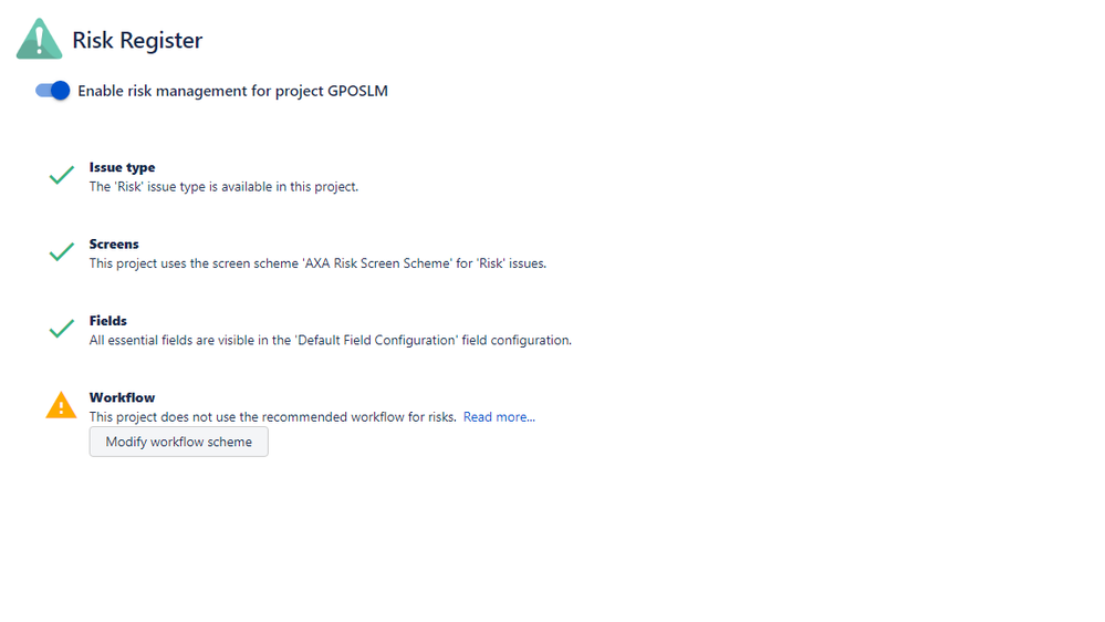

Thank you. I tried this above option, but still did not get the required risk register enabled. Please see attached screenshot.
I have a separate workflow for Risk Register, when I add this workflow to the project specific workflow then the simplified workflow is getting removed from the project.
Please let me know if there is any solution to achieve both Simplified workflow + Risk Register in a single flow. Thank you.

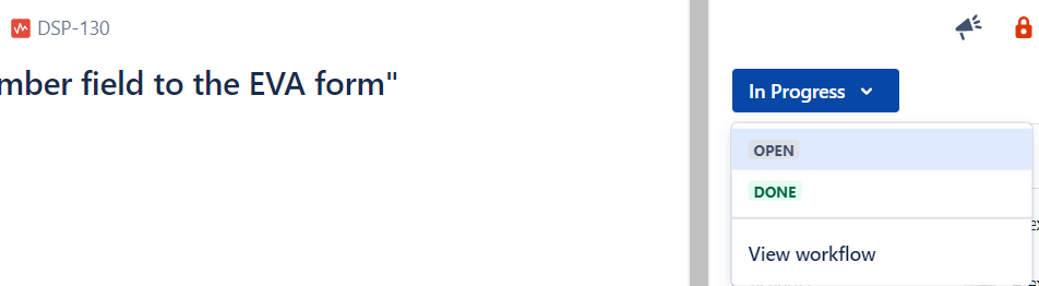

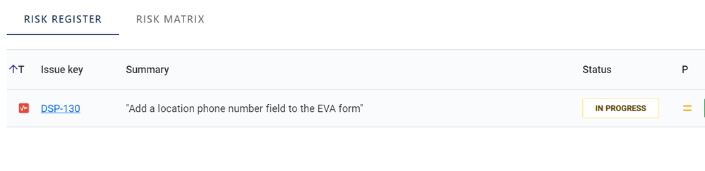

I've install this addon you are talking about, and created a risk. However this addon will not alter the workflow of your issue types. Kindly see images below:
This means that you have to associate the simplified workflow to THAT issue you are using as a risk. If there are multiple issue types, then associate all of them with the simplified workflow. And just to be clear. A simplified workflow would be a workflow with no restriction and no transition among statuses (and other things which you can read here)
Hope all the above helps.

Thank you for the reply. I am using the same plug-in. When I try to enable, the workflow which is simplified already is getting disabled.
Workflow.pngFor the Risk register, I have separate issue type, workflow, screen scheme and field scheme to ensure this is enabled.
Could you please let me know how should I enable risk issue type for this workflow to achieve both (Simplified workflow + Risk register)
Many thanks.
