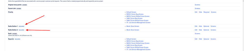

Regarding the radio button's Behaviour, it may be related to the SRJIRA-5699 Bug.
To proceed, please try these steps:-
  1. Temporarily disable your Behaviour.
  2. Next, go to the field configuration page and set your Radio Button fields to required, as shown in the screenshot below:-
  3. Next, re-enable your Behaviour but ensure the required option for your radio button is removed.

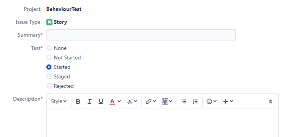

  4. Now go to your issue, refresh your browser, try to create an issue and check if the None option is still visible for the Radio Button.
  5. If it does not appear, try to select one of the options on the radio buttons. Then, go back to the Field Configuration and set the Radio Buttons back to optional.
  6. Next, re-enable your Behaviour, set the Optional / Required toggle for your radio button to Required and try to re-test it once again to confirm if the None option is available now.

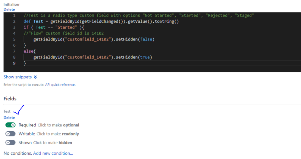

KSKumar55
August 23, 2022
@Pramodh M , I tried the code in above mentioned url, but it didn't work after saving the behavior settings.
The custom field is not appearing in the create issue screen.
I executed the script in inline console of the initialiser.
Vikrant Yadav
August 23, 2022
@KSKumar55  Kindly apply script on Radio button Custom field then only it works.

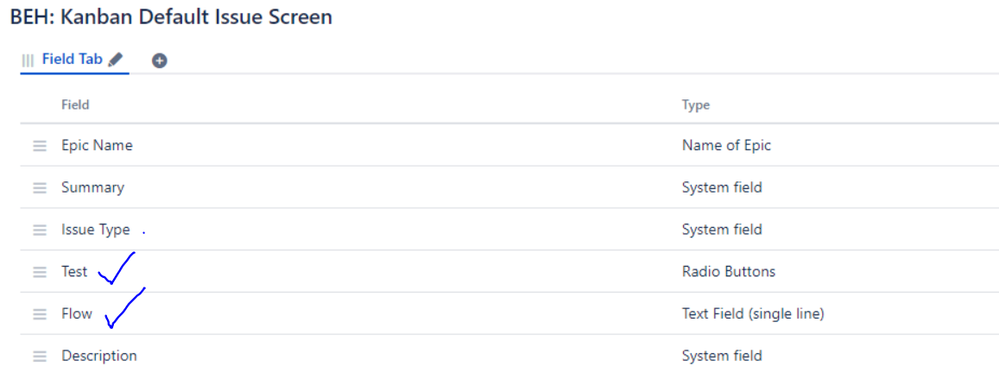

KSKumar55
August 23, 2022
@Vikrant Yadav , @Pramodh M , I added the field as shown in the screenshot but still unable to make it work, can you please help.image.png

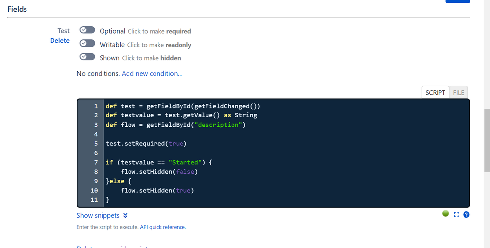

Vikrant Yadav
August 24, 2022
Hi @KSKumar55  Kindly apply Behaviour on Test Field, like below screenshot :-
Instead of making field mandatory from Behaviors, it would be better use Field Configuration for making field mandatory , so that None option won't visible on screen.
def test = getFieldById(getFieldChanged())
def testvalue = test.getValue() as String
def flow = getFieldById("description") //replace with your custom field id
test.setRequired(true) //kindly make field mandatory from field configuration
if (testvalue == "Started") {
flow.setHidden(false)
}else {
flow.setHidden(true)
