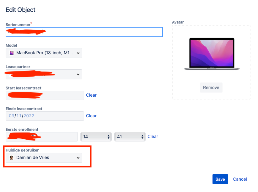

In a different object type called Macbooks we have objects which represents macbooks with an object attribute referencing the user Damian.
I will add an image for clarity.

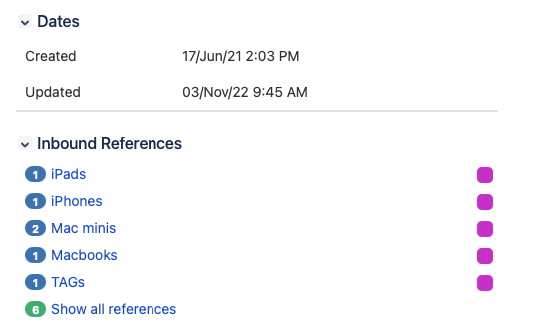

On the user Damian we can see the Inbound References:
So ultimately my question is how can I see the inbound references with detail on a user described in the way above. So that when we have Damian selected in the object field on a Jira issue we will be able to see the specific device he is connected to. How do I tackle this?

When you assign a user "Damian" to a device like a "Macbook", actually Your Macbook contains an attribute with an object type "user" (it is like a foreign key is in SQL terminology).
This is in Jira terms, considered as an outbound reference from the mackbook to the user.

So the other way around, it is even worse:
If you get to the users object view, you will, apart from the defined attributes, not be able to define an extra column in the view that show the devices that user Damian is currently holding. Forget even about some important attributes on those devices you want to view in that user view.
JSM asset Management, forces you to click on the user 'Damian' and then click on any of the different inbound references to the devices that Damian holds, like for example the macbook.
Then click again on the pop-up to check some important attributes.
