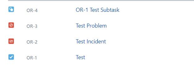

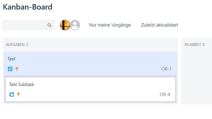

So i created a new Service Desk Projekt. No special settings in it. After this i wanted to create a kanban board that displays all of the tickets that are in the service desk.
The Service Desk has the Issue Types: Incident, Problem, Task and SubTask.
The Tasks and Subtasks are displayed fine in the Kanban Board but how can i get the board to also display he Incidents and Problems?

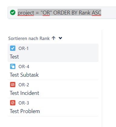

i just checked the filter and it is the default "project = "OR" ORDER BY Rank ASC" and this filter also shows me all
Thanks for these screenshots, it's helpful. What is your Kanban board sub-filter?

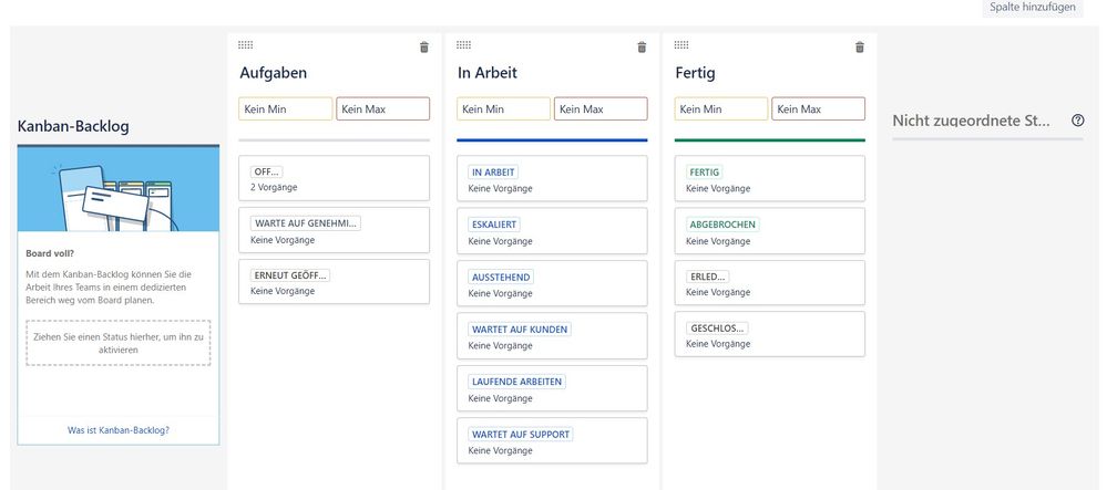

Can you also check your incidents and problems status? Are these statuses mapped to any column in your board (see Configuring columns)?
The Kanban Board Subfilter is the default one: fixVersion in unreleasedVersions() OR fixVersion is EMPTY . I tried to change it to issuetype with all of the 4 types or completely removing the filter but it did not help.
All of the Issues are currently in the status open but not even mentioned in the column configuration (sorry for the german language in the screenshot)
@Marco - do you mean that the status in which are the incidents and problems is not mapped to any column? What if you transition an incident or problem to a status that is mapped to one of the columns, do they appear on the Kanban board?

What i meant was that you can see in the screenshot there is no unassigned status. and in Open (offen in german) there are 2 issues shown, which are the task and the subtask. so that means that the board does not "care about" the incident and the problem so far at all.

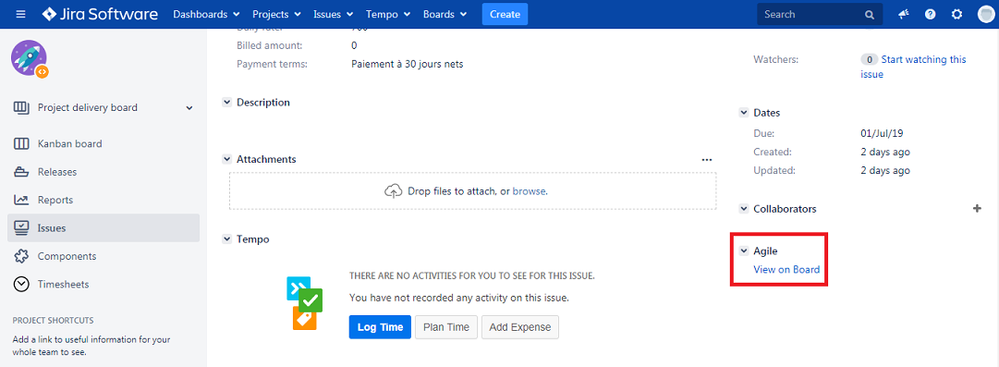

@Marco - I don't have any Jira with both Jira Software + Jira Service Desk to try it out right now, but do you have a "View on board" button on your incidents and problems?
they had different workflows but that did not do anything since i tried to give the inc/prob the same workflow as the tasks.
I cannot find a "view on Board" Option in our cloud instance.

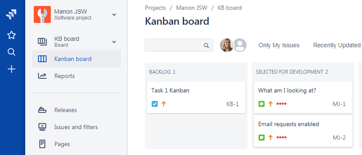

Oh ok, you're on Cloud - I thought you were on Server. I've just reproduced your use case and it's working fine (KB = Jira Software project, MJ = Jira Service Desk project):
