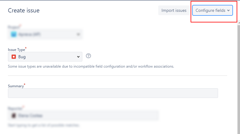

elenushhh
May 22, 2019
Hello, @Nevena_Marinkovic

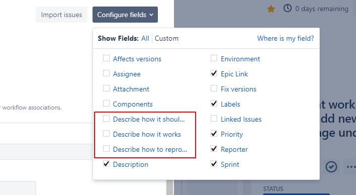

I've also added 3 custom fields for bug issue type. So I think I can help you. :)
I didn't created a new issue type screen scheme for bug because I added the fields to the default one, just in case I will need those fields on other projects, but it's your choice.
So if you added them already, try to create a new bug issue type and on the upper right corner of the screen you'll see a button "Configure fields", you have to add them from there, and also you can configure you're bug issue type only with the fields you need.
Create issue   Ninja Coders 2.pngCreate issue   Ninja Coders.pngDescribe how it works
Describe how it should work
Describe how to reproduce it
These are the 3 custom fields I added for bug issue.
Hope this is helpful.
