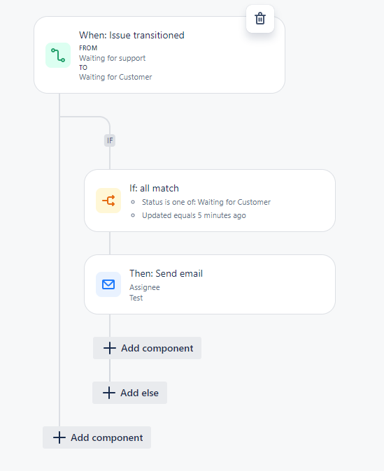

Hello, I'm trying to set up an automation to send an email if a ticket status has been the same for 2 days. We use JIRA for a customer support portal and if the status is set to 'Waiting for Customer' for 2 days, I'd like to send out a reminder email. My current automation setup is included below:
The automation can see that it's happening but it isn't taking any action:
Is there another field I should be using besides updated? My thoughts were that the ticket was updated from waiting for Support to waiting for customer 5 min ago and that should trigger the email. (I'll change this to 2 days when my testing is finished)
Appreciate any insight!

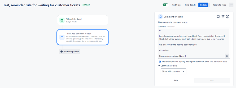

You should be able to find the tickets using JQL in a Scheduled Trigger - eg.
status = "Waiting for Customer" AND not status CHANGED AFTER -2d
For example, rule might look like this...
  • Trigger: Scheduled
    • Run rule every = 1 Days
    • Run a JQL search = TRUE
      • JQL - status = "Waiting for Customer" and not status changed AFTER -2d
  • Action: Comment on issue
    • Comment = <comment here>
    • Prevent duplicates by only adding this comment once... = TRUE
    • Comment visibility = Share with customer
I've assumed the email is going to the customer - by using the "Comment on issue" action instead, you can prevent duplicates and the customer should still get an email notification.

Hi @Ste Wright ,
Thank you for your response and apologies for the delay. This got put on the back burner for a while.

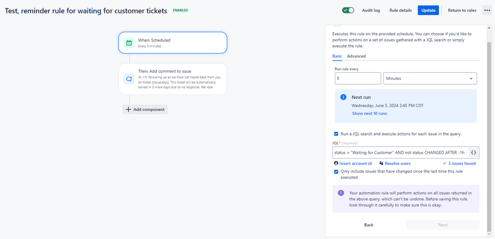

I attempted this first option and here is what my set up looks like:

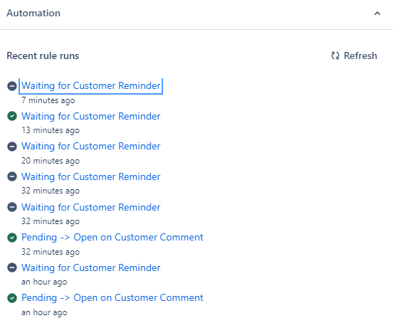

Unfortunately, no event is triggered despite the validation running and finding the 3 issues I created as a test.
I set the intial time to run every 5 minutes and the status not changed for 1h for testing purposes. Is the issue the -1h?
Any insight is greatly appreciated.

Hello @Colby Smith
Couple of changes.
You need to do a scheduled trigger instead of Issue transitioned and pass a JQL -> status = "Waiting For Customer", uncheck exclude issues checkbox..
And then in your If condition, Instead of Updated equals 5 mins, try Updated greater than 5 mins.
Then manually run the rule to see if email is triggered.

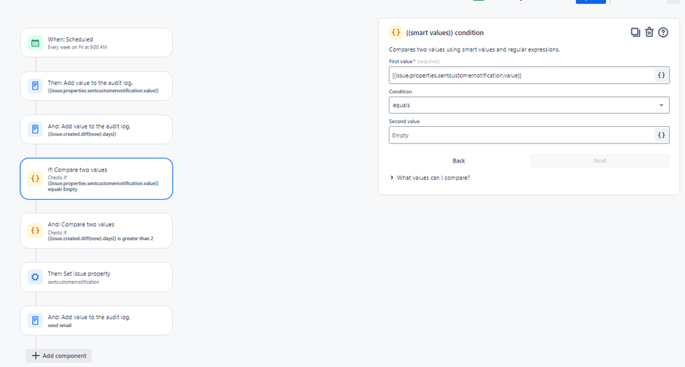

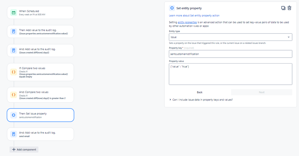

At a high level, there are 2 ways to solve this.
Either use an unused field to store that you have sent an email or store it in entity property.
I am sharing how to do it using entity property action.
Basically if you go into a rule and choose components, action and search entity, its one which says "set entity property", select that for this purpose..
So, You will start with scheduled trigger and give a JQL => status = "Waiting for Customer".
IMPORTANT NOTE: To test, give just 1 key whose status is waiting for customer.. so a JQL like => key = ABC-123 ..that way, you are not running across all issues and sending a ton of emails..
Then follow along the belong screenshots and implement.. Do try to log as I have so we know whats happening..
Trigger the rule couple of times, first time will send email but next time it wont.
Let me know if questions..
Again, you can do the same with storing it in an unused field as well.. Its the same. This is just one of the approaches..

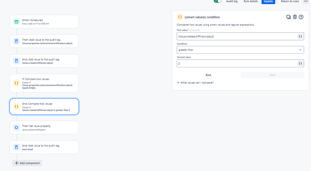

Kalyan Sattaluri
April 12, 2024
BTW, my If condition is checking if created was 2 days or older.
You want to test 5 mins logic, change if condition check to {{issue.created.diff(now).minutes}} instead for your test purposes.

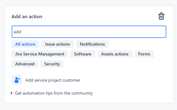

Colby Smith
April 12, 2024
@Kalyan Sattaluri Thanks again for the help here. Unfortunately, I don't see a THEN: action to add value to the audit log.
Kalyan Sattaluri
April 12, 2024
Just type "Log", it will show up.. Log Action..
