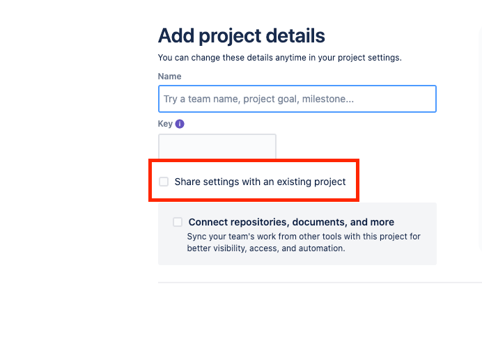

You cannot set up an actual template that will be available in the project creation process for a Company Managed project. Instead what you do is actually create a project and create all the schemes that you would want to use as a template. Then in the project creation process, when you get to the point of entering the Name for your project, you can select the option to "Share settings with an existing project", and then select the project that you have configured with all the schemes that you want the new project to use. The new project will be created with all those same schemes associated to it automatically.
For existing projects, you would have to modify each project's configuration to assign the "template" schemes to it, which could lead to the need to make significant updates to the project usage if there are significant variations from the schemes they already use and the "standard" schemes you want all projects to use.

Thank you for your response. This is disappointing. After reading this description:
https://support.atlassian.com/jira-software-cloud/docs/what-are-team-managed-and-company-managed-projects/
I assumed It would allow for me to have a standardized workflow and project setup. The "Share settings" process is awkward and people forget what the template project is named or they forget to click the box.  Currently we have 50ish projects with workflows named after the project and 50ish different statuses to map to my roll-up board. I had hopes that this problem was resolved.
Sounds like I will need to get all the Project Managers to follow the pattern moving forward. In the meantime I will migrate old projects to the new workflow and get things back on track.
Thanks again for the assistance! forgive me for my disappointment :)

You cannot promote a project to be a template, but what you could do is create a project that you use when you create other projects. Then at the end when you name the new project you can select your template project to share the configurations with the new one.

I would suggest creating a project with all of the configurations added and name it "*Project name* template".
You could have a "Development Project Template", or "Support Team Template", etc. This should make it easier when employees are unsure of what project to choose once the "Share settings with an existing project" is checked.
