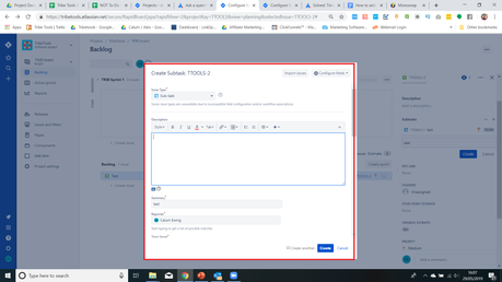

1. When a new Sub-Task is created under a Story, the 'Time Spent' field is mandatory. How do I set this as non-mandatory? It's a new sub-task so no time has been spent on it. I've tried changing in the field configuration but no luck.

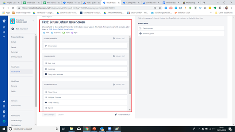

3. When I change the layout of my issue screen, it's not reflected in real time. (Screenshots below)
Any ideas?

1 - The name of the field used to fill the time spent is called Log Work and there are two ways to make it required:
- Setting it at the project settings > Fields > find the field and set it as optional
- Using a validator in the create transition, in Project settings > Workflows > Edit > Click in the create transition (Diagram mode) > Validators
Please, check if the Log work field is set as required in one of the settings above

3 - Check if all the related fields of the layout are flagged in the Configure fields option displayed in the first screenshot you sent
