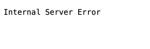

hi @Peter_DevSamurai i tried but keep getting 'internal server error' i established an app in atlassian developer and gave all required scopes

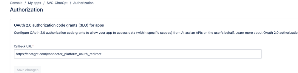

BTW your chatgpt flow is the old one- now its apps&connectors not plugins, so the url should be https://chatgpt.com/connector_platform_oauth_redirect
i think i did everything as excepted but something is not working for me.

As corrected, change the OAuth Redirect URI to: https://chatgpt.com/connector_platform_oauth_redirect; besides this everything should still remain. If the error persists, can you share the error payload or screenshot. What's your Chatgpt plan -> This may affect the connector limits.

here is the screenshot i get. nothing else

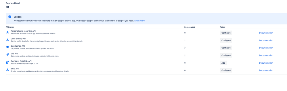

attached screenshot of the app i created in jira developer:

1) Re-verify scopes:
  • Your scopes look good, can you help me ensure the below are included: offline_access (for refresh), read:jira-work, read:confluence-content.all (or granular like read:confluence-content:SPACEKEY), and read:me.

4) If Still 500: Which happens more common than you think
  • Clear cache/cookies for auth.atlassian.com and chatgpt.com. You can try incognito.
  • Regenerate API token on service account (id.atlassian.com > Security > Tokens > Classic scopes including offline_access).
  • Test token validity: curl -H "Authorization: Bearer TOKEN" https://api.atlassian.com/ex/jira/{cloudId}/rest/api/3/myself (get cloudId from admin.atlassian.com > Site settings > General).
