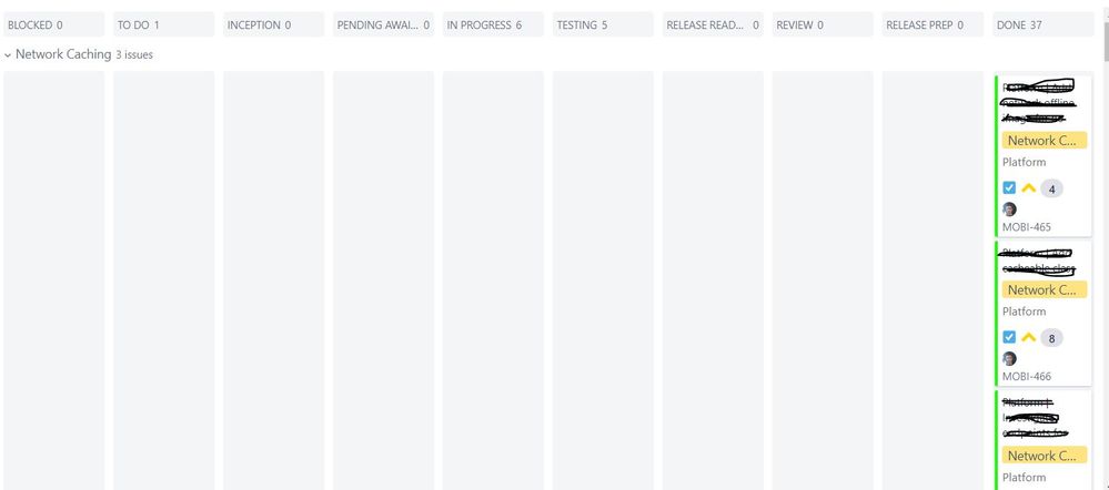

Bianca Hildebrand
February 15, 2021
Sure, I am trying to get these tickets set to done, on the board, even though they are in the "done" column and status reflecting done or invalid, they are not closed and keep rolling over into new sprints.

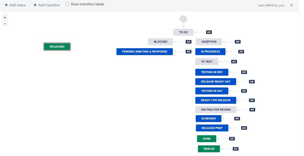

On my workflow, I have two statuses in the done category, "done" and "invalid" is it possible those two statuses could be causing the issue? This is the workflow I have setup
Jack Brickey
February 16, 2021
ok so yes I think the issue is this...
You have issues in the Done status but the Resolution is not set and you cannot set the resolution as they are non-editable in Done status. Is that correct?
if so then two options:
  1. if only a handful of issues and you are ok with reopening the issues then move them from Done to some to do or in progress status. Now before you do this please ensure that you have the necessary solution in place to now set the resolution. That is, either the WF requires the user to select the resolution when moving to Done or there is a post function in the transition to Done that will set the Resolution.
  2. If you have a lot of these then you will want to use bulk edit. You will need to temporarily add a transition from Done back to itself and add a post function on that reentrant transition to set the Resolution to done. Then construct a JQL that finds all done but no resolution (project = xxx and status = done and resolution is empty). Then use bulk edit to transition all of these issues.
hope we are getting close. :-)
