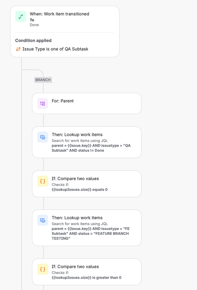

I’m trying to build a Jira Automation rule and I’m stuck on getting the transition to apply to the correct subtasks.
Setup
  • Parent issue has multiple subtasks of three types:
    • QA Subtask
    • FE Subtask
    • BE Subtask
Goal
When all QA Subtasks under the same parent are transitioned to Done, I want Jira to automatically transition:
  • FE Subtask and BE Subtask
  • only if their current status is “FEATURE BRANCH TESTING”
  • to Done
Is this possible to achieve?
Transition item will move the item, i want to move the FE Subtasks to done not the parent

Matthew Farrugia
March 10, 2026
Added the current rule, what is pending is moving the FE Subtask to "done" but cannot figure out if this is achievable

The rule you have is using For Parent. That moves to focus of the rule to the parent of the trigger issue. Any action that you take in that rule, like Transition Work Item, will be executed against the parent unless you have a method to move the focus to a to the subtasks that you are looking up. Since it is not current possible to have a For Branch within another For Branch, the solution as you are trying to build it cannot be done.
The solution I presented in my previous response should work.

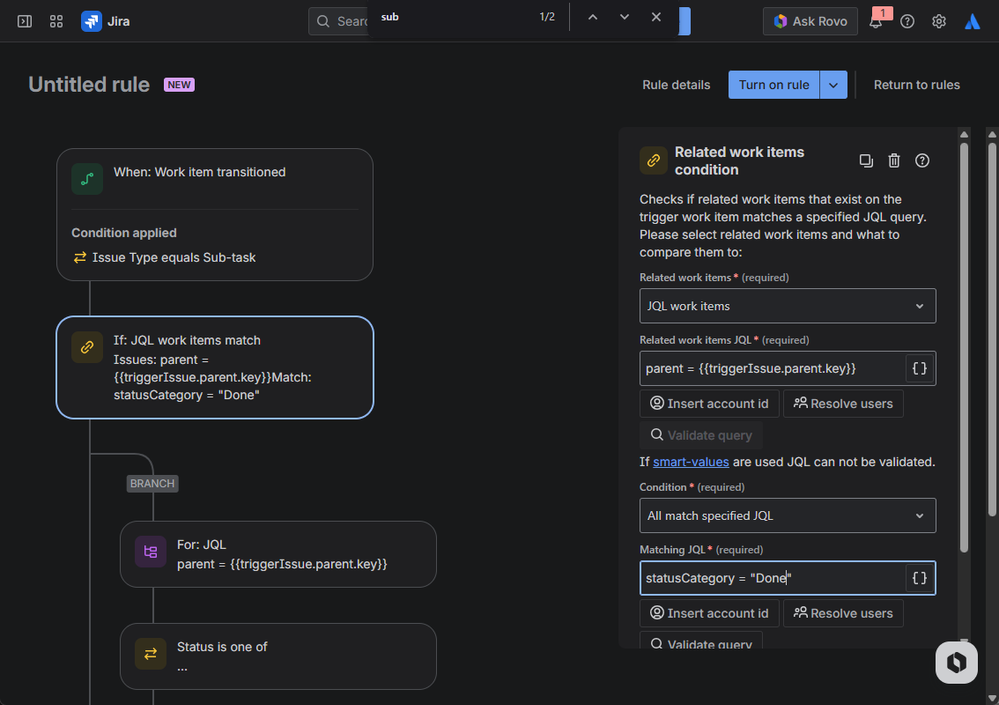

Tomislav Tobijas
March 10, 2026
Hey @Matthew Farrugia ,
This should be possible. Although one question:
You mention here that sub-tasks are transitioned to done, and then below, you say that you're looking to see if they are in status "FEATURE BRANCH TESTING."
So, I'm wondering which one it is?

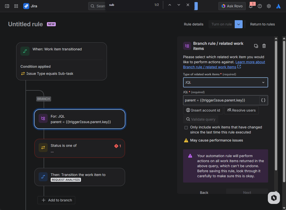

Anyway, let's say you would like to iterate through each sub-task under the same parent. You could build something like this
But, you could also use related issues condition (potentially before the branch) to, let's say, check if the statuses of all other sub-tasks are in a specific status or status category.
This is the quickest I could think of, but there might be some more optimal solutions.
Again, if you could clarify the actual use case/requirement, that would be helpful.
Cheers,
Tobi
