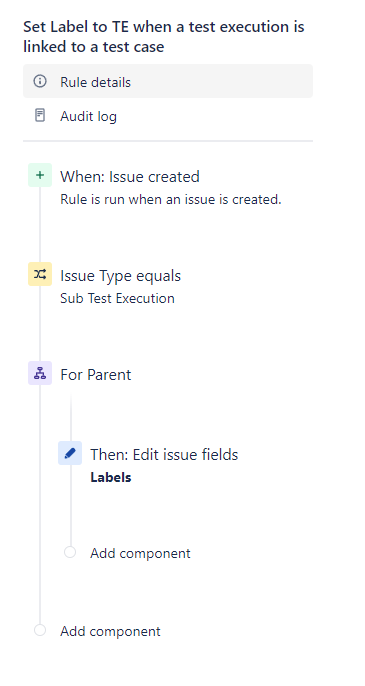

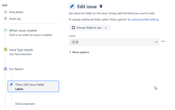

Hi @Alex ,
the easiest way would be to add the execution as a sub-execution of the story. In this case you could create the automation rule similar to the previous one:
  • when: issue is created
  • condition: issue type equals sub test execution
  • branch: for parent
  • action: edit issue, field lable, set value "TE"

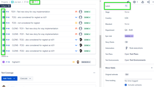

Stefan Salzl
February 21, 2022

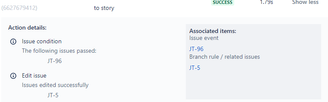

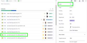

My tests went OK. I tested like follows:
  • given - a User Story with test cases inside
  • when - I generate a sub test execution within the story by clicking "Execute - with Sub Test Execution" in the Test Coverage area of the story
  • then - Sub Test Execution is created as subtask of the story
    • and - Label of story (parent of the Sub Test Execution) is set to TE
(see screenshots)
given
when
then
audit log output

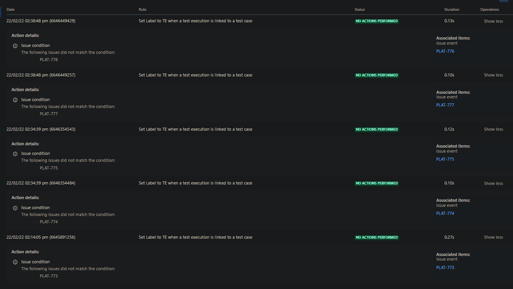

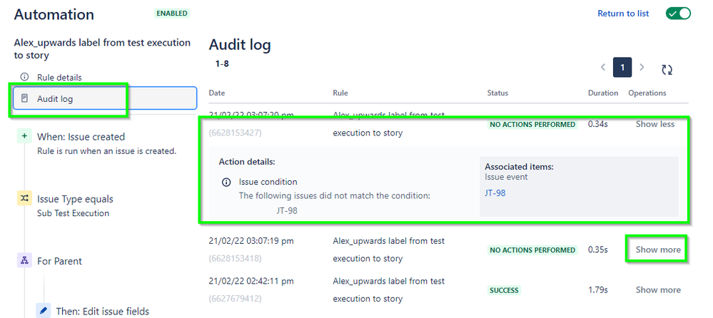

audit log
if you are in your automation rule screen there is "audit log" in the left upper corner (right below the rule details). If clicked the view on the right side will show audit details (different activations of the rule). By clicking on "show more" in of the activations even more details are shown (eg. what was processed within the rule) --> see screenshot

Alex
February 22, 2022
I've followed the steps suggested above for creating test executions from a test case but the automation doesn't seem to be triggering and assigning the label.2022-02-22_14-45.png
Stefan Salzl
February 22, 2022
Did you create the sub test execution out of the story (as described in my previous) or out of the testcase (you just wrote from test case)?
THEN: changing back to the Story A, section "Test Coverage"
click execute & choose "with sub test execution"
Could you please show a screenshot of your automation rule? And if possible of how and where you created which test execution (everything that would help analyzing)

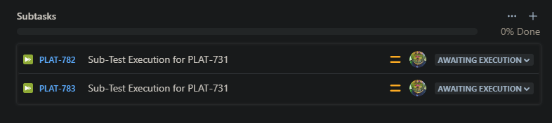

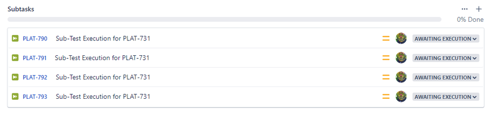

Alex
February 22, 2022
I've just tried it another three times and each time two sub-test executions were created.
Steps I performed:
  1. Opened the task to test.
  2. Scroll down to the test coverage section.
  3. As there are no tests I click on the blue add tests dropdown and click new test.
  4. I open the test in a new tab.
  5. Add some test steps.
  6. I go back to the task I was testing.
  7. I clicked the execute dropdown and select with Sub-Test Execution.
  8. I didn't change any details on the modal that opened, I just clicked create.
  9. When I go back to the task I was testing I see two sub-test executions. In the screenshot below I actually went through steps 7 and 8 twice which is why there are 4 listed)

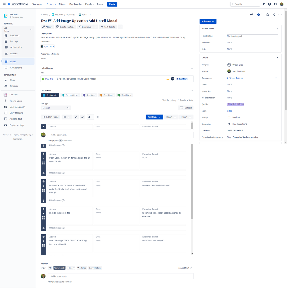

Alex
February 23, 2022
The automation works.

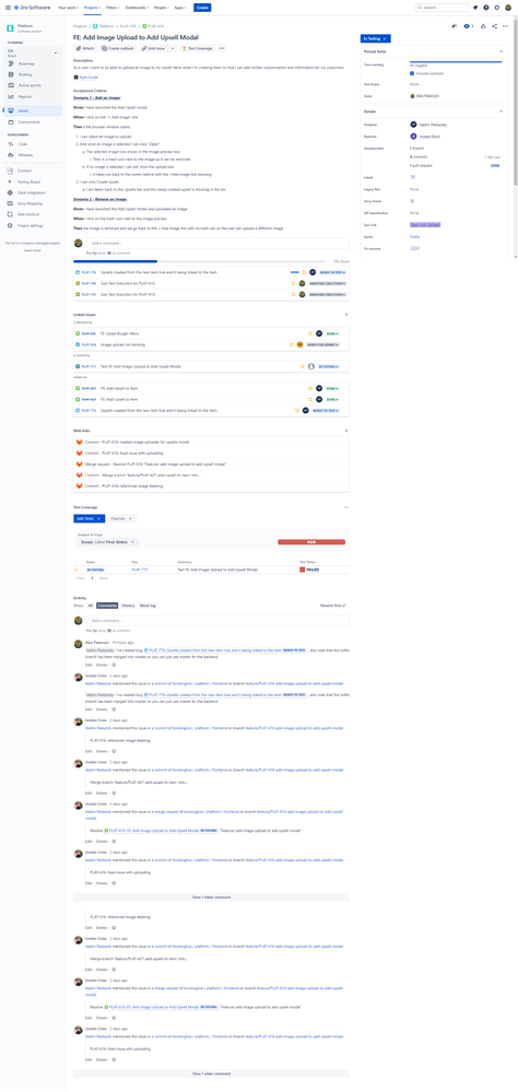

616 is the task and 773 is the test.
The images are quite large, I'm not sure if they will work well on here. I may need to upload them somewhere else and post a link to them.
-PLAT-616-FE-Add-Image-Upload-to-Add-Upsell-Modal-Jira.png-PLAT-773-Test-FE-Add-Image-Upload-to-Add-Upsell-Modal-Jira.png
