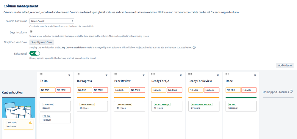

I have spent some time in google and here trying to figure out why on some boards I can move my tickets to the status of "Done" and this marks the field of resolved. I have one board that when combined with Confluence it appears that a ton of issues are unresolved because well as far as JIRA is concerned they are. I have no way of marking a resolution or that they are resolved when i go to the tickets details nor on the quick view (right side of board).

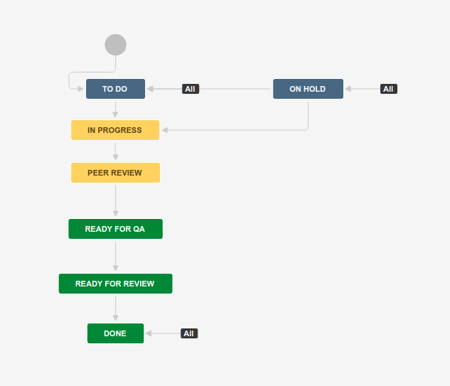

On another board (where resolutions are working) the status under board configuration has a check box for "Set resolution" indicating when a ticket/issue gets moved to that status it will set the issue as resolved. The only difference I can identify between that board and the board that is NOT working is the affected board uses a custom workflow. I have checked the workflow to see if I have the ability to set the resolution flag there but I do not.

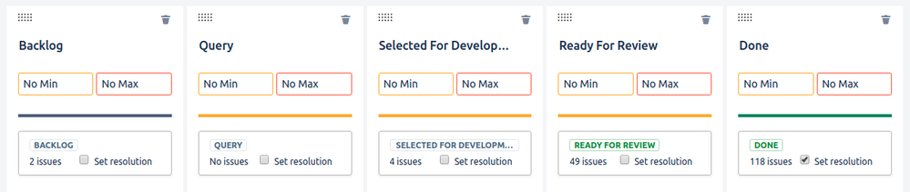

Attached is what a board that has the option looks like, I was really hoping to figure out why I dont have this option on my other board.

It isn’t a function of your board. The board is a ‘slave’ to the workflow. If you are the admin then find the workflow(s) associated with the project(s) that are not behaving as you would like then do the following for each:
  1. edit the workflow in diagram mode
  2. double-click on each and every transition into “Done” or closed depending on your situation, I.e. the final status where Resolution should be set.
  3. click on Post Function and add a post function
  4. find the function the update a field and add it
  5. select Resolution and set the desired value, e.g. Done
  6. publish the workflow
  7. test
  8. rinse and repeat for every unique workflow as desired.
