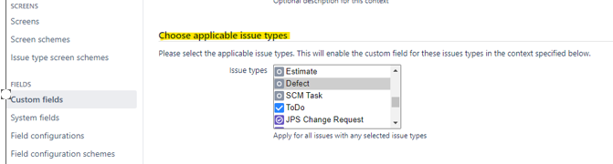

Cat Camacho
September 30, 2022
I solved this exact issue-
  • Go to the "custom fields" screen via Admin settings (under Issues)
  • Where you can select "Applicable Issue Types", change the selection from "All issue types" to the issue type where the field you are trying to mark required is located. Please note, this solution only works for fields that exist in one issue type only (that I found.)
  • Then go ahead and mark required as needed.
This should resolve the "requirement" type on other issue types. If the field you want to mark required is in more than one issue type but you only want it required for one issue type, I would suggest creating a duplicate custom field and assign it to the associated issue types and leave that one unmarked as required. Probably not best practice in reporting, etc. since the fields will be the same and unable to be differentiated but it will work.
Hope that helps.
