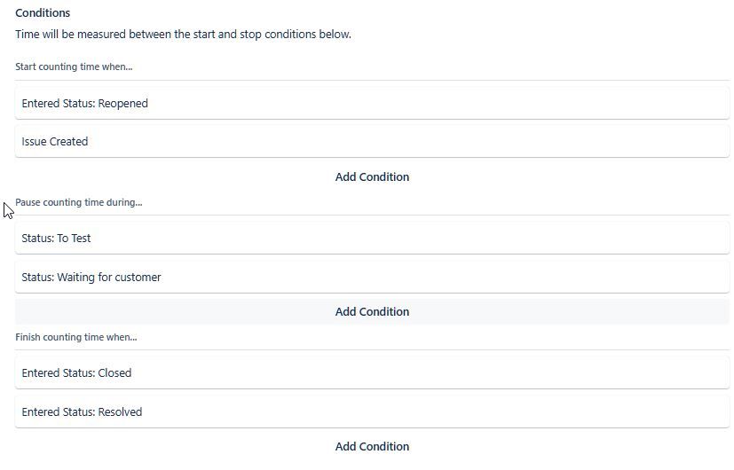

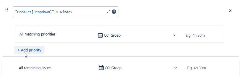

Setting of my SLA:
2024-06-17 16_25_45-Support 1e lijn - Service level agreements - Service project - Livits Jira.jpg
2024-06-17 16_26_33-Support 1e lijn - Service level agreements - Service project - Livits Jira.jpg
So when creating an issue and changing the product, it still has an SLA which, in my opinion with the settings above, should not be the case.

Hi @Sabrina Boetzkes,
From your explanation, I cannot clearly derive what brings you to the statement that "it" still has an SLA.
In short: if you specify a JQL filter to add target timings to your SLA, a box with that SLA target and a timer should be displayed on issues that match that filter. Issues that don't match the filter and don't get a target should not have the SLA target visible.
However, if you already had a calculated SLA on these issues and you changed the configuration afterwards, it may happen that old values still show. I am not 100% sure if this is still the case, but in the past SLA's on already closed issues (issues where the SLA timer had met its end state) were not recalculated when you change the configuration. Maybe this is impacting your specific use case?
If you are seeing data that seem inconsistent with your current settings and that cannot be explained through the points I mentioned above, you may consider forcing a recalculation of your SLA's on the issues you consider wrong. You might inspiration on how to do this in this support article.

Sabrina Boetzkes
June 18, 2024
@Walter Buggenhout , thanks for your response. It made me realise that I have been approaching this whole thing from the wrong end. The issue should match the SLA and if it doesn't it doesn't get any. So I had to change this thing around and make sure that product type 1 matches the SLA completely and product 2 does not.
Changed it in the settings of the SLA and now it finally works. So probably should have asked my question earlier as it took me quite some time to figure out.
