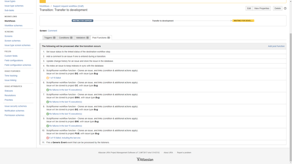

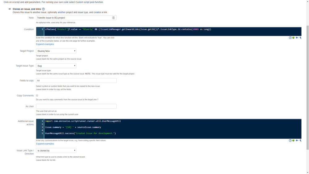

Thank you for your reply. Below are screenshots from the clone-and-link configuration and the workflow in which this function is called.
Please note that I disabled the additional issue actions which caused problems, so you do not see them here.
Thanks,
Geert
