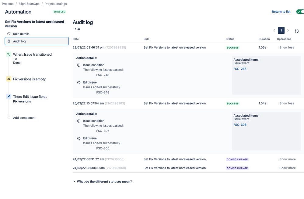

Paul Dokken
March 30, 2022
Here is the audit log.  The 20 that I mentioned should meet the condition that all are transitioned to done and Fix Versions is empty. The reason I have the rule global is I want it to run on both my software projects which each have their own Fix Versions.

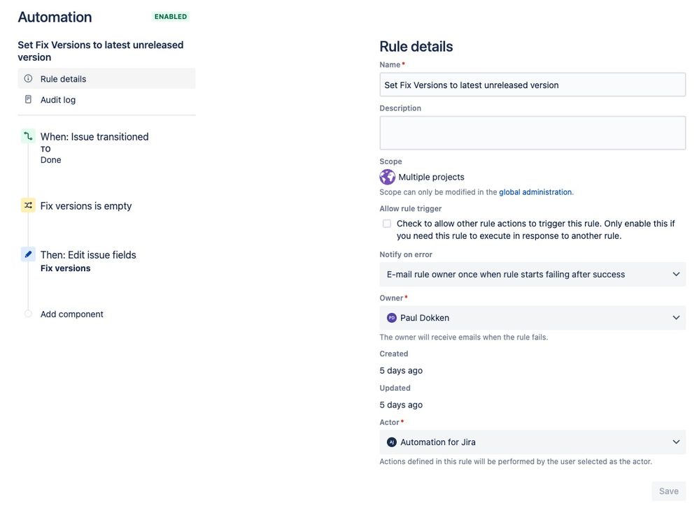

I thought it was working but has only worked on 2 issues out of about 20 that have already been done.  I have made sure the scope is set for the project.  Any ideas?
Bill Sheboy
March 29, 2022
Hi, Paul.
When you note it only worked on 2 issues out of 20, what are you observing happening?
Can you post images of the audit log details showing executions where it worked and did not work as expected?
Next, I notice you have set this up as a global scope rule.
  • Is that intentional or do you just need this for one project?
  • The reason I ask is that versions are set up by project, and so I wonder if something in the edit is not working as you expect when versions are not set up for a project.  What I would expect for that case is the Fix Version is cleared in that case.
Kind regards,
Bill
Paul Dokken
March 30, 2022
Hi Bill,
Here is the audit log.  The 20 issues that I mentioned should have met the condition of transitioning to done and Fix Versions is empty to only 2 ran.
The reason I made the rule global is that there are 2 software projects and each of them have their own Fix versions.
Bill Sheboy
March 30, 2022
Thanks for that info, Paul.
According to the audit log, the rule seems to be triggering for only one project: FSO.  Were there other issues for that same project which did not trigger the rule?
And, are these Company-managed or Team-managed projects?
I ask because the "Done" status for company-managed project is probably a shared/reused status in your Jira site.  For team-managed, each project has its own set of status values.  So perhaps the rule is not picking up one of them for the project.
If one (or both) projects are team-managed, you can check this by copying the rule to one of the projects, disabling the global rule, and see if the project-specific rule works as expected.

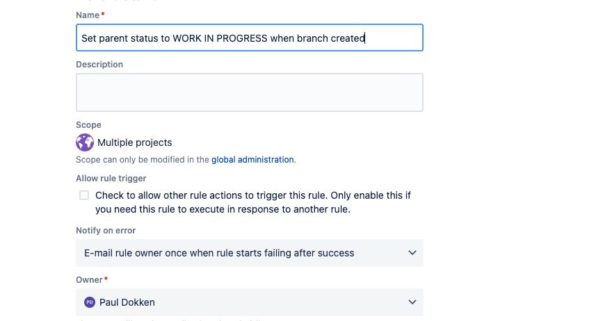

Paul Dokken
March 31, 2022
FSO is a team managed project.  The scope is now just for software projects.  I am wondering if I need to have the Check to allow other rules... checkbox checked since I have an automation that moves the status to to done. automation.jpg
Bill Sheboy
March 31, 2022
Ah...yes, you do.  The "Allow rule trigger" option does that.  The default is disabled to prevent a runaway rule/looping condition, and in your case you want one rule to trigger another.  Sorry I missed that!
Like Paul Dokken likes this
