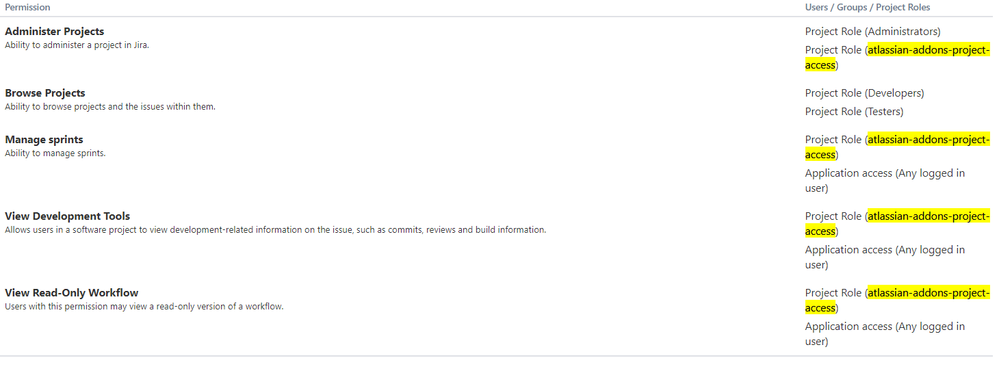

Can you share screenshots of the appropriate permissions for the atlassian-addons role along with the Issue Level Security setting?
Andrea Mazzeschi
October 27, 2020

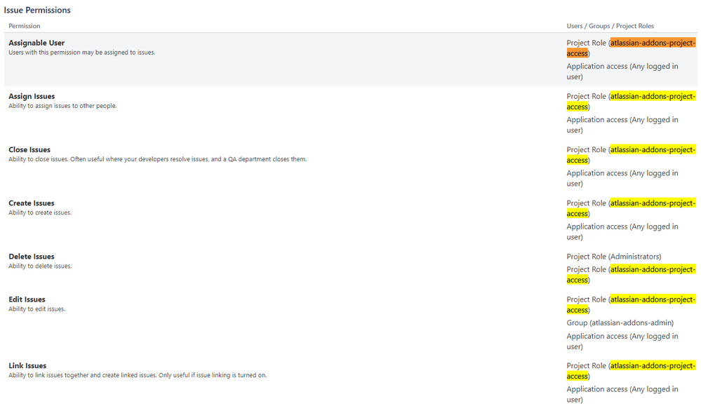

Hi @John Funk  thanks for your answer, here is the screenshot.
Like Marco Brundel likes this
John Funk
October 27, 2020
Not sure if that's the problem or not, but that project role does not have Browse Project permissions. I would add that first and see what happens.
