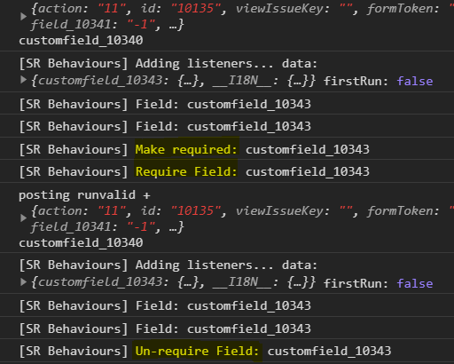

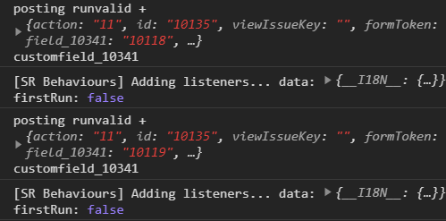

I checked what happens in the console and do believe the problem is that I somehow can't use the value of b in the behaviour field of a and vice versa.
Everything works fine in the upper one, but not in the one below. (The action does not get triggered for customfield_10343 = c)

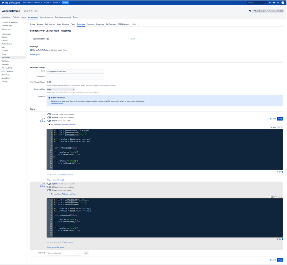

Instead of using the || i.e. or condition to differentiate between the selected list options, it would be better to create 2 separate Server Side behaviour i.e. one for List A and one for List B.
Below are two sample Server Side Behaviour codes for your reference:-
1. For List A
def listA = getFieldById(fieldChanged)
def listB = getFieldByName("List B")
def textC = getFieldByName("Text C")
def listAValue = listA.value.toString()
def listBValue = listB.value.toString()
textC.setRequired(false)
if(listAValue == "Yes" && listBValue == "Yes") {
    textC.setRequired(true)
2. For List B
def listB = getFieldById(fieldChanged)
def listA = getFieldByName("List A")
if(listBValue == "Yes" && listAValue == "Yes") {
Below is a print screen of the Behaviour configuration:-
Hope this helps solve your question :)
