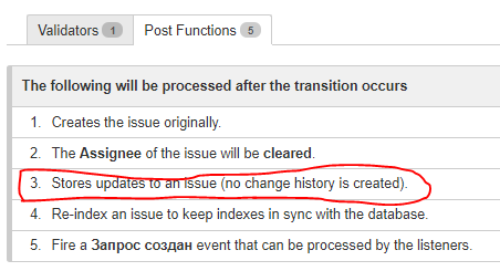

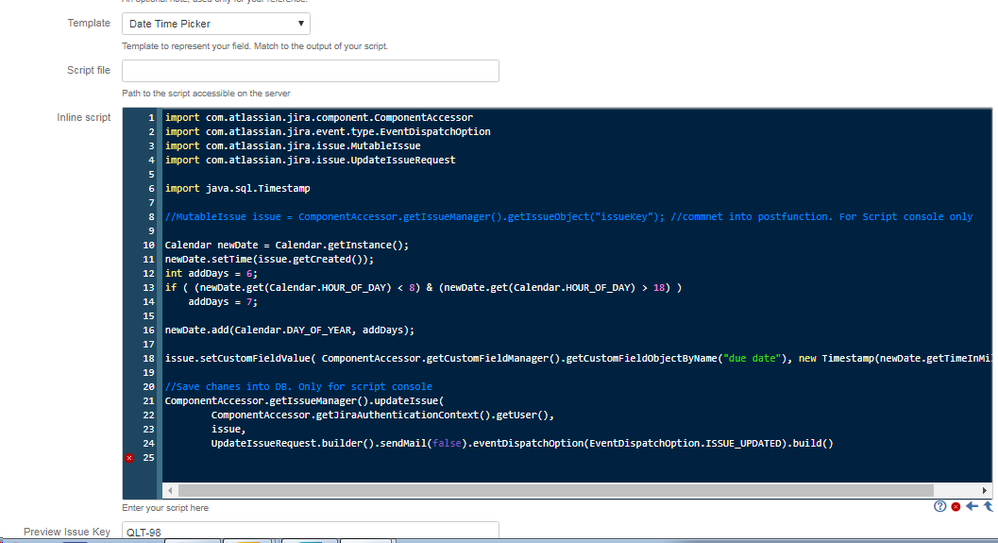

After trying it, I noticed that in my create transition I have already built in the option of store.
See screenshot attached of your script and where I place it in my transition.
You can see also the "store" option below it.
The script still doesn't work.
 Your help and advise please

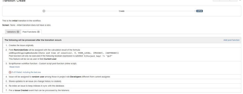

@אריג' חמדאן, you need to postfunctions:
first one to set date as I provided
second one to store changed values to DB. This is build-in postfunction is for.

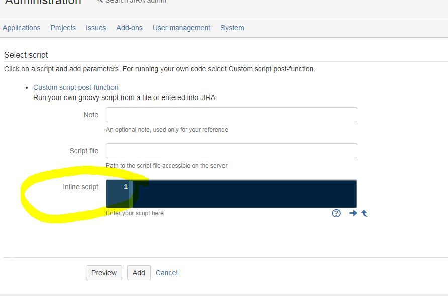

Dear @אריג' חמדאן, open you workflow, choice create transition and go to postfunction tab. You will see several postfunctions here.
To realise you requarement you should manually add two postfunctions discribed above. See this: https://confluence.atlassian.com/adminjiraserver0710/advanced-workflow-configuration-953144832.html

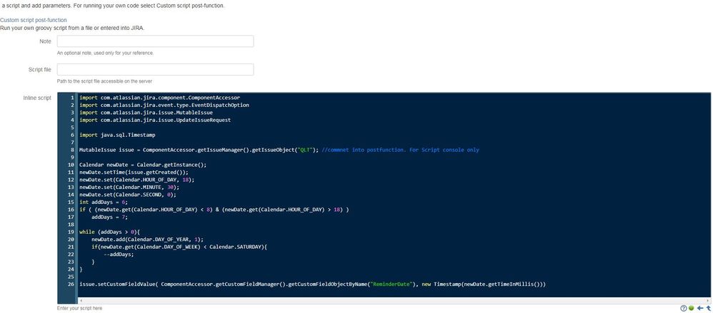

create transition.JPGscript postfunction.JPGinline script.JPGhi
i know to do that
see screenshot below' i had set your script into inline script.
which another post i should choose from my postfunction? to set to it the second part of your script?
thx

Open postfunction tab on any transition and you will find a postfunction to store chages into database, exept create transiton. Lets suppose you have 5 postfunctions to change diffent custom values. If you want to have only one record into change history you should call store to DB only once.
After this open postfunction tab of create transition on any workflow. There is no store to DB postfunction. It means that any changes made by postfunctions will not be stores to DB.
So, on create transition press "Add postfunction" and choose one names like "Store changes to DB".

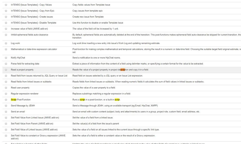

  • Can you plz send me a postfunction's screenshot where i can see this option: "store changes to db" because i had just done what you asked me to do step by step but unfortunately  couldn't find this post on my create transition.
Maybe a screenshot will help me to understand what i am missing.

Vasiliy Zverev
January 20, 2019
