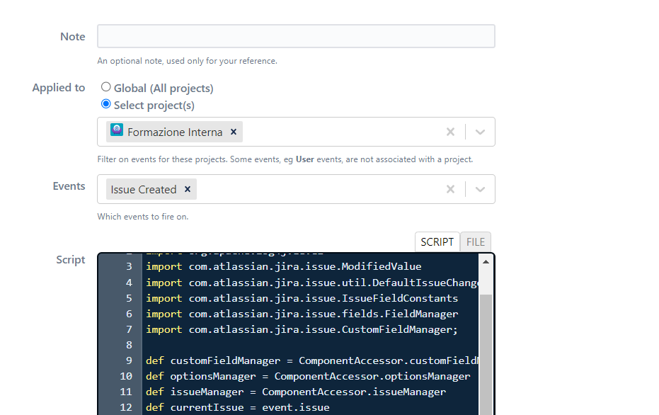

Hi folks,
I'm trying to set a checkbox through scriptrunner at creation of a subtask and when the parent is a specific ticlet type.
Here follows what I wrote in the listener. the triggering Event is "issue creation"error scriptrunner2.PNG

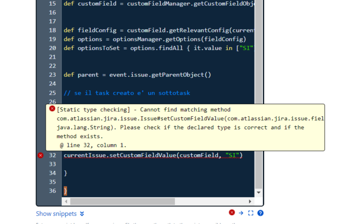

the name of the Checkbox filed is "Richiesta formazione" and has one single possible value: "SI"
the error I get is: Cannot find matching method

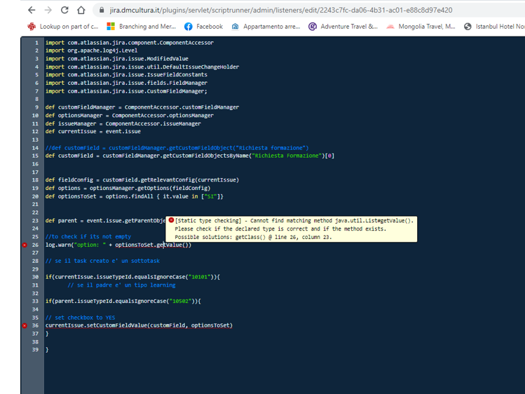

pasquale.scandurra
November 4, 2022
Hi and thank you again.
I'm still getting a couple of errors . Not sure it's a library issue or a type issue.
Do you have an idea?
/Paerrors.PNG
