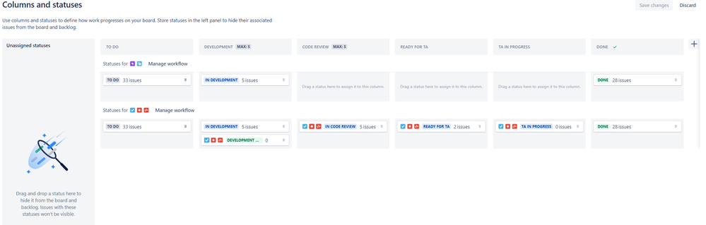

ronny matthies
March 14, 2023
Thanks @Alex Koxaras -Relational- for the quick answer. In fact I´m working on a team managed project. Please find below my columns and status configuration.

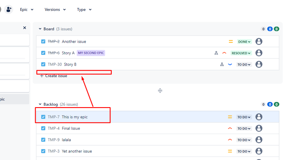

Hi @ronny matthies
If you mean that you drag n drop from your backlog to your todo status, which is actually the same status, you just remove the issue from the backlog:
Then, to my knowledge you can't automate this. Even with the API there isn't any flag/variable/parameter provided which indicates that the issue is in/is not in the backlog.
