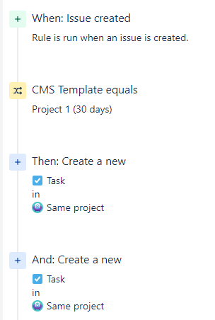

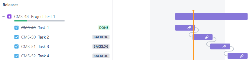

Thanks for the quick response. The reason for the linking of child Tasks is to create a waterfall dependency structure for Project Management (I know, agile is the way to go, but we have constraints with these groups). It allows for automation to automatically adjust start dates when tasks go over, like so:Waterfall Dependencies.png
Here is the automation for the first 2 tasks. I tried your last suggestion but that doesn't seem to help. I've tried branching but can't get anything to reference the due date of the last created task at all.:

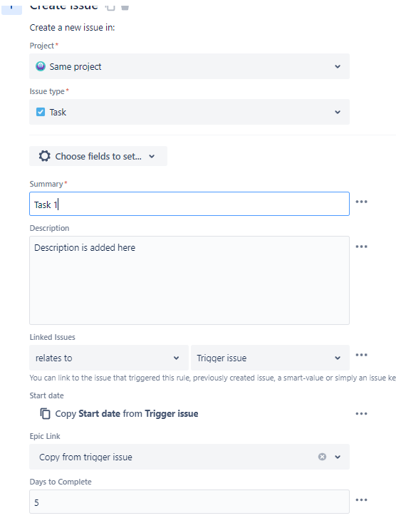

Here is Task 1 in detail. This is working, because I can reference the trigger issue for the start date:

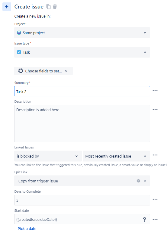

Here is the detail for the second task automation, which is the one that is NOT working:
The end result is below - the tasks are created and linked correctly, the first task has the correct start/end date, but the 2nd task is not catching a start date at all, no matter what I try:

Next thing to try: smart values are name, spacing, and case-sensitive.  And, the one for Due Date is normally this {{issue.duedate}}  so perhaps try this for updating the next issue: {{createdIssue.duedate}}
I also recommend writing {{createdIssue.duedate}} to the audit log to confirm it works as you expect.

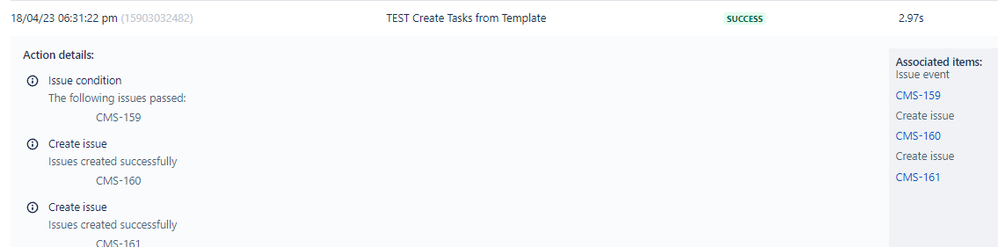

Thanks @Bill Sheboy - I initially tried lowercase 'd' in date as you suggested, but have seen it as uppercase in other posts so tried that also. I just changed it back to lowercase per above, and same result. Here is the audit log (not very telling):

@Eric Younkin I don't see in the Automation where you are setting the Due Date for Task 1. Are you setting its Due Date in this same automation rule?
If the Due Date field on the Task 1 is not getting set, then that would explain why the Start Date for Task 2 has no value.

@Trudy P Claspill , YES!!! I didn't even think of that, but you are absolutely right. I was setting the due date with a separate automation used to keep tasks in line as they are worked. When I changed it to be part of this automation, that solved the problem!
