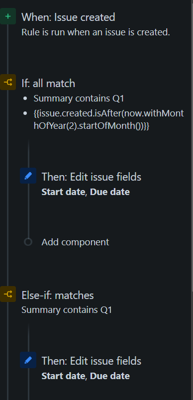

Adam Channing
February 26, 2023
Okay I eventually figured out the correct JQL and smart values to use to get this right. So the condition for checking if the issue created date is after the first day of March (current year) is:
{{issue.created >= (now.withMonthOfYear(3).startOfMonth())}}
So to check whether a task created should be assigned to this years quarter (e.g. Q1) or next years based on the created date now works! :)

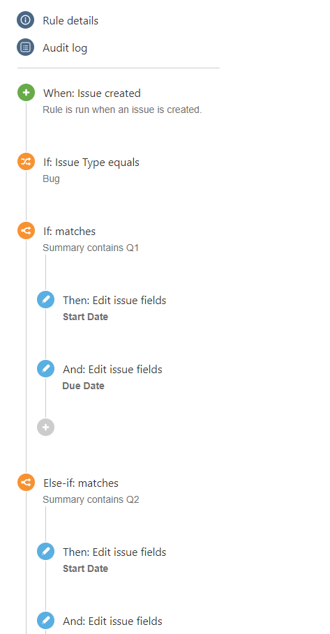

Vamsi Kandala
February 16, 2023
Hi @Adam Channing
Welcome to Atlassian community!
This is what I did when creating the automation rule:
  • Select the trigger as 'Issue created'
  • Checking if the issue type is of specific one, in this case 'Bug'
  • Added 'if / else block'
    • Added the 'Issue fields condition'
    • Selected 'Summary' for 'Field'
    • Select 'contains' for 'Condition'
    • Entered 'Q1' for 'Value'
  • Selected the 'Edit issue' as 'New action' component
    • Selected 'Start Date' and entered '{{now.withMonth(3).endOfMonth}}'
    • Selected 'Due Date' and entered '{{now.withMonth(6).endOfMonth}}'
  • Repeated the process for Q2, Q3 and Q4.
  • Q2
    • Start Date - {{now.withMonth(6).endOfMonth}}
    • Due Date - {{now.withMonth(9).endOfMonth}}
  • Q3
    • Start Date - {{now.withMonth(9).endOfMonth}}
    • Due Date - {{now.withMonth(12).endOfMonth}}
  • Q4
    • Start Date - {{now.withMonth(12).endOfMonth}}
    • Due Date - {{now.plusYears(1).withMonth(3).endOfMonth}}
I am enclosing the screenshot for your reference.
Hope this helps.
Thanks,
Vamsi
Adam Channing
February 16, 2023
Thanks so much!

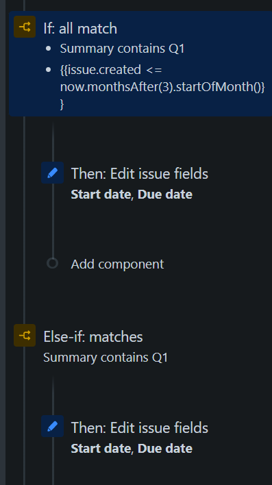

So in trying to set the start/due date according to the quarter in the title, e.g. Q2, I also want to set a condition to check if the current date is after the end of Q2.
But even though we havent reached Q2 yet, the issue is still setting the start/due dates to next year.
If Block:
Issue Fields Condition:
Summary contains Q2
and
JQL condition
{{issue.created >= now.withMonth(6).endOfMonth()}}
Then
Edit Issue Fields:
Start date
Due date
Else
Summary contains Q2
Then
Vamsi Kandala
February 17, 2023
Hi @Adam Channing
To be clear, let me clarify this.
Supposing the ticket was created on July 14th 2023.  This falls in Q2 and is between the dates 06/30/2023 and 09/30/2023.
So, since Q2 already started for this year, you want to set the Start Date and Due Date for this ticket as 06/30/2024 and 09/30/2024 respectively.  Am I correct?
Or, like we are in Q4 now.  So, any ticket that gets created today will have the Start Date as 12/31/2023 and Due Date as 03/31/2024?
Thanks,
Vamsi
Adam Channing
February 20, 2023
Thats exactly it! :)
My GRC tool sends tasks to Jira as soon as the old one is done, so quarterly scheduled tasks appear in the same period if I dont check for this.
Even so, I still want to keep the flexibility of scheduling new tasks for a given quartner and not have them automatically get assigned to next year. Hence my struggle!
