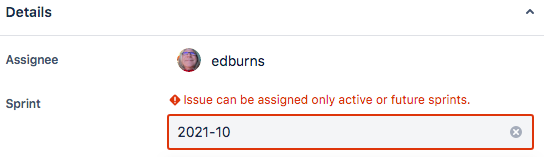

Thanks for your answer.  Unfortunately, when I try to do that I see:
Any idea how to work around this? I was thinking I could re-open the target Sprint, move the issues into it, then complete it again.

But then, I don't know how to re-open a sprint.

Hi @edburns
You can find reopening the sprint by going to the reports page under sprint or sprint burn down report. There should be an area that allows you the option to reopen.
