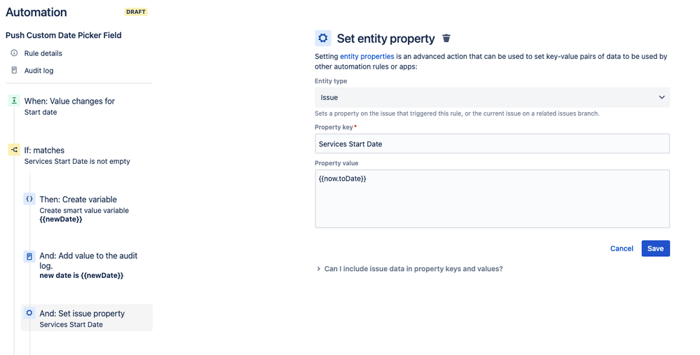

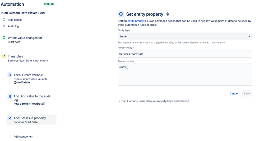

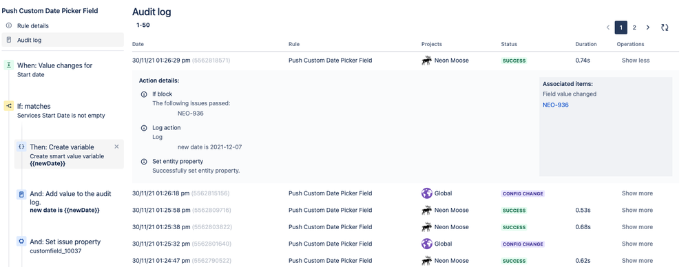

I'm looking for another perspective on how to set a custom field with a calculated date value based on an automation trigger. I'm able to create the calculated date value with the help of @Bill Sheboy and this post, but I am having difficulties in setting the calculated date value via the "Set Issue Property" (aka "Set entity property") action. Here is the full automation:
You will see I created a variable {{newDate}}, which is:
{{issue.customfield_10037.plusBusinessDays(fieldChange.from.toDate.diff(fieldChange.to.toDate).BusinessDays)}}
This does return the correct calculated date value. However, when I use the "Set Issue Property" (aka "Set entity property") action with either of the screenshotted configurations below, the logs note "Successfully set entity property." but the entity property isn't changed.
I'm pretty sure there's a simple thing I'm missing here, but I'm spinning my wheels at this point.

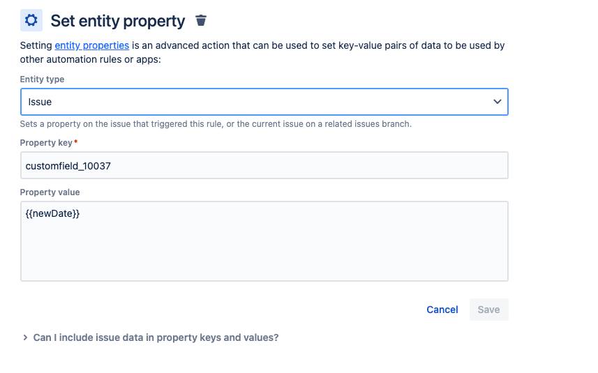

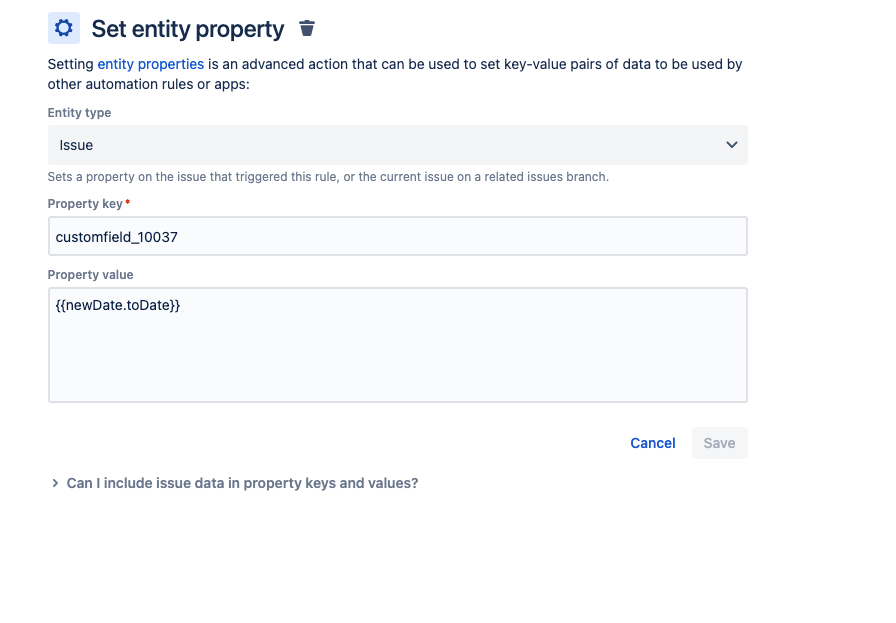

I've tried your suggestion and used the "name" of the property without success unfortunately. customfield_10037 is the "id" and "key" of the field, and includes the underscore. I've tried removing the underscore as well just in case ("customfield10037") without success.

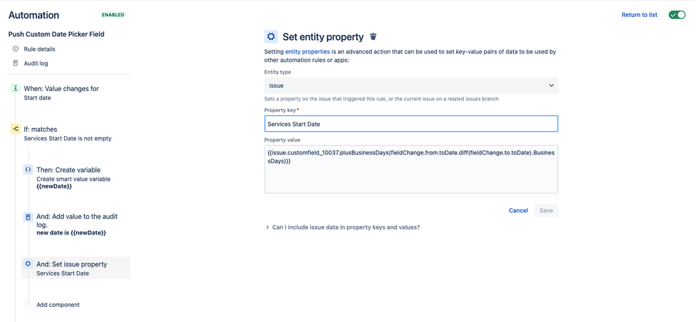

For the avoidance of doubt I have also pasted the formula directly into the "Set Entity Properties" action.
Could there be a type issue when setting the entity property? Or a key issue somehow that I'm not realizing? I've also tried the below, and the custom field doesn't actually update with the now timestamp.
Screen Shot 2021-12-01 at 9.19.14 AM.pngScreen Shot 2021-12-01 at 9.19.04 AM.png
