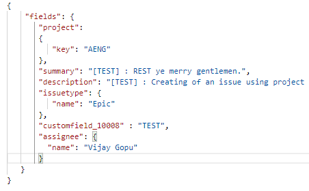

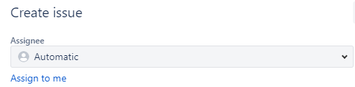

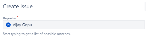

Yes both Assignee and Reporter are on the create screen. i have passed name in the request, but that didn't get assigned on the ticket either.
The first screenshot is to show that reporter is available on the create screen and the second one is to show that assignee is available on the create screen.
The third screenshot is request payload with assignee set to my name, and the final screenshot the assignee was unassigned on the JIRA ticket. The response from the API is 201 created.

@Vijay Gopu  , do you login to the jira system using the username 'Vijay Gopu'?
That looks like a display name rather a username. Can you check on that?
For JIRA cloud, don't you login with an email address?
Vijay Gopu
August 11, 2020
Thanks @Fazila Ashraf

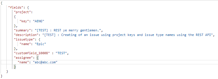

i understood what you meant, it was a bit confusing with name being username. I tried it using my username (which is my email address) but it didn't work, what worked was passing accountId for both assignee and reporter.
Didn't work:
Although i don't like the double hop (i.e using emailaddress to get accountId and then using it while creating an epic or story), i will probably go that route.
Worked:
