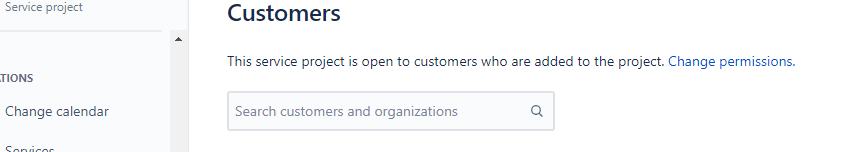

Hi,
I have created a team with 5 members in the Service Project Portal.
MY question would be the following, every time someone submits a ticket and share this with the group. Everyone can see that this ticket was created, but everyone receives a notification by e-mail.
Is it possible to disable all email notifications and still be able to see the tickets submitted by others?
Many thanks in advance,
