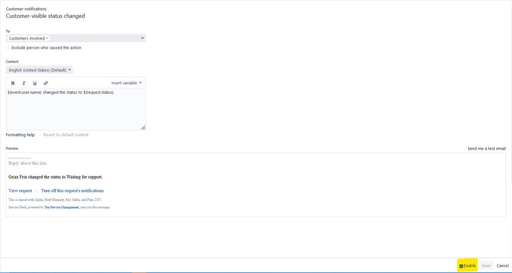

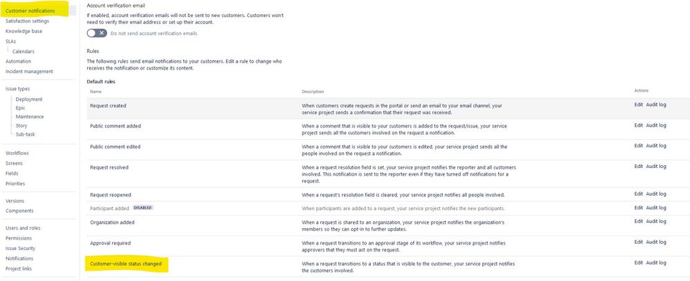

Just adding this after a bit more digging on my part, so our 'Customer-visible status changed' notification was disabled on our project. <facepalm> Now I just gotta figure out which statuses are customer visible. Also, finding the Enable checkbox was a bit of a mystery so inc a SS of it as well.
