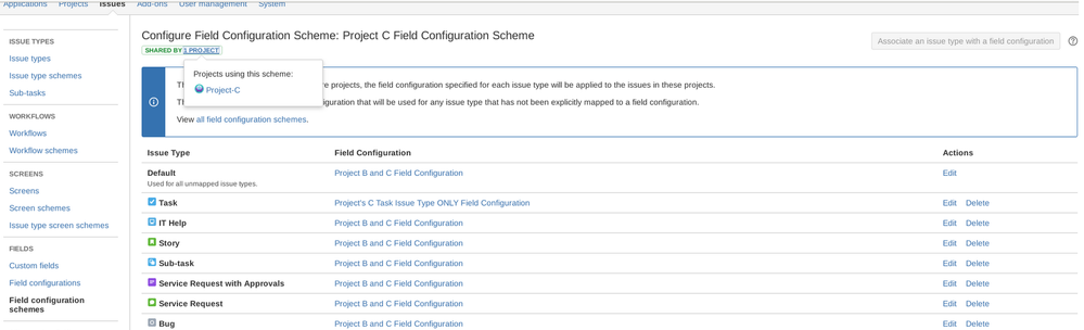

you have to create a seperate Field Configuration and a seperate Field Configuration Scheme for Project C.
  • First, make a copy of your existing Field Configuration of Project C
  • Edit the copy, rename it to project-c-task or so
  • Then configure the new field configuration:
    • Hide the field "Description"
  • Make a copy of your existing Field Configuration Scheme of Project C, so that it can be seperated from Project B
  • Edit the Copy, call it "Project C Field Configuration Scheme" or so
  •  Then configure that new Field Configuration Scheme
    • Associate the issue type "Task" with the Field Configuration "Project C-Task" and save it
Now, the field "description" should be invisible for tasks.

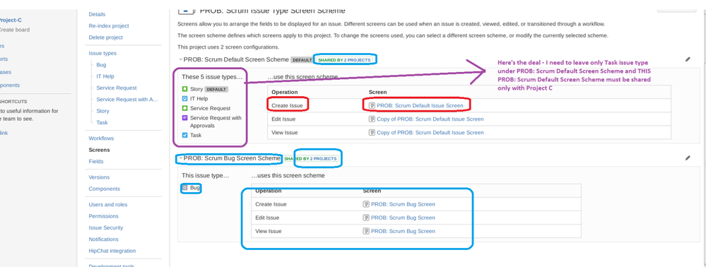

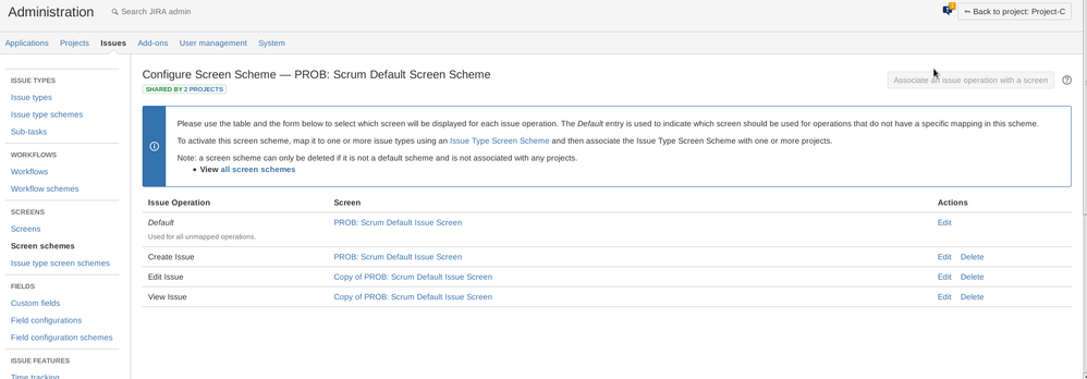

to make it fully done:
accessed project C, used GP shortcut
I've associated:
--> create issue screen with PROB: Scrum Default Issue Screen (Description Field must be ABSENT HERE)
--> edit issue with Copy of PROB: Scrum Default Issue Screen (Description Field must be PRESENT HERE)
-->View Issue with Copy of PROB: Scrum Default Issue Screen (Description Field must be PRESENT HERE)
by doing so I have "Description" field removed from the "create issue" screen and present when editing and viewing the issue.
Unfortunately it affects all issue types (and I need it only on task issue type). I've noticed that "Bug" issue type isn't affected by this and it works as the "Task" issue type as it uses its own "Bug Only Issue Type Scheme":
2017-04-20 16_12_08-jira 04 2017 (Migawka 9) [Uruchomiona] - Oracle VM VirtualBox _ 1.png
I'll investigate the issue and consult it with my manager.

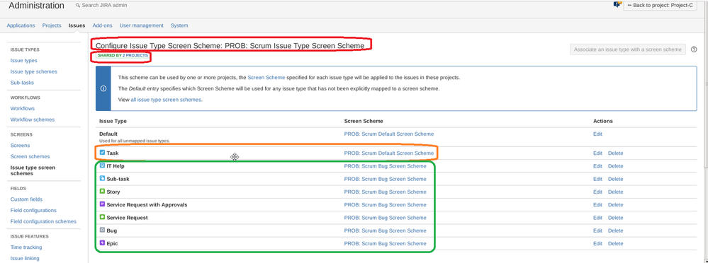

Field configuration schemes can be made up of field configurations for each issue type. It sounds like you need one for task issues and one for all others.

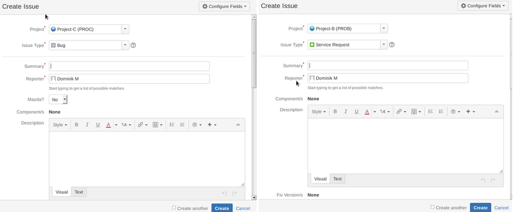

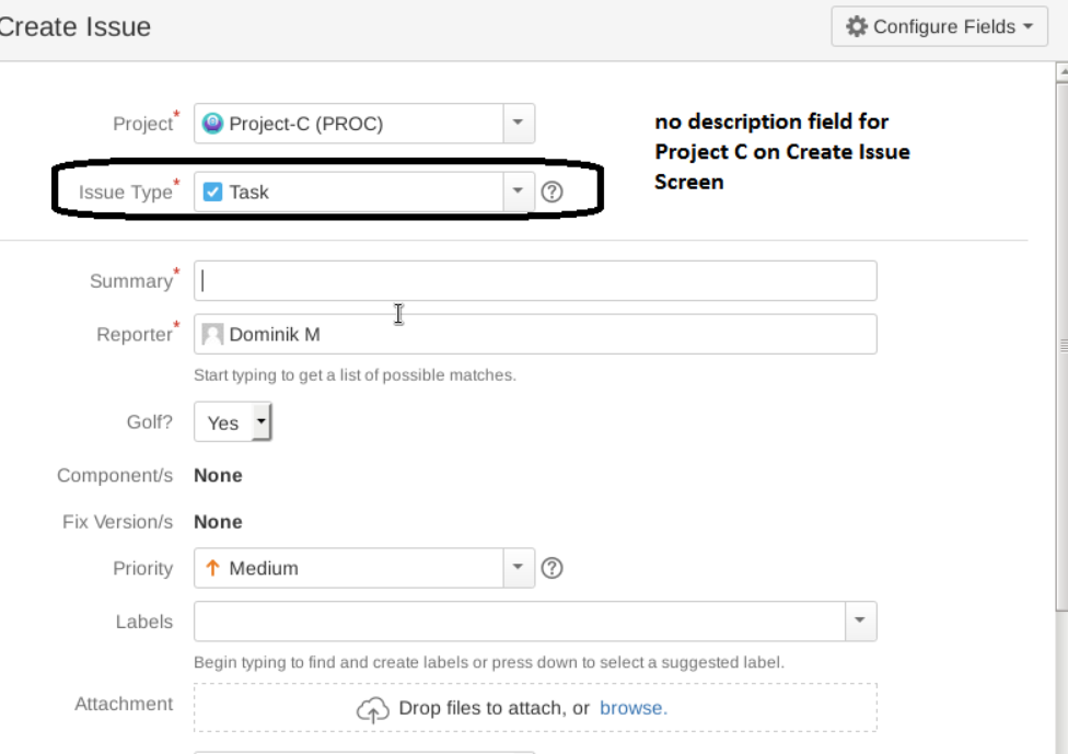

Correct, here's the final part which in fact led to Description's field in Task Issue type in Project C to be present only on create issue screen (vs Project-B where it should've been left with Description Field on Create Issue screen)

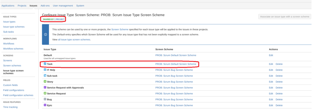

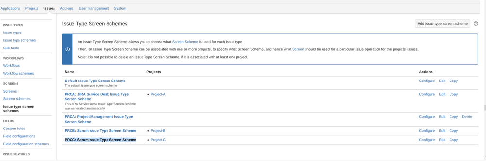

so far, so good except the fact that issue type screen schemes are shared for 2 projects.
what needs to be done here is now FIRST to differentiate project's B screen schemes from project C and then amend them.
I've copied PROB: Scrum Issue Type Screen Scheme and saved it as PROC: Scrum Issue Type Screen Scheme, then it was associated with Project-C
2017-04-21 10_49_05-New Jira Setup and 2 projects - Dominik Maciejewski - Space.png

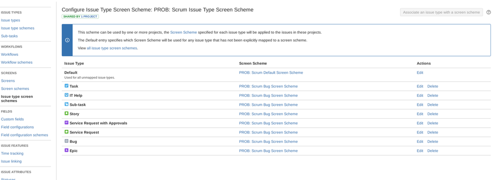

now it's time to do amendments only for Project-B Task Issue Type:
2017-04-21 10_49_53-New Jira Setup and 2 projects - Dominik Maciejewski - Space.png
outcome:
2017-04-21 10_50_41-New Jira Setup and 2 projects - Dominik Maciejewski - Space.png
and testing phase time!:
2017-04-21 10_51_58-New Jira Setup and 2 projects - Dominik Maciejewski - Space.png
above everywthing nice and smooth as it should be

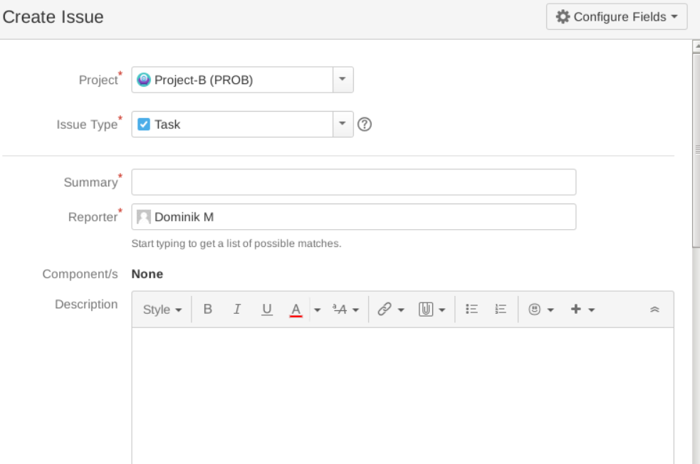

Project-B:
2017-04-21 10_52_45-New Jira Setup and 2 projects - Dominik Maciejewski - Space.png
2017-04-21 10_53_30-New Jira Setup and 2 projects - Dominik Maciejewski - Space.png
edit screen/view screen tests were done as well and description field is present for task issue type in Project's-C only on create issue screen.
