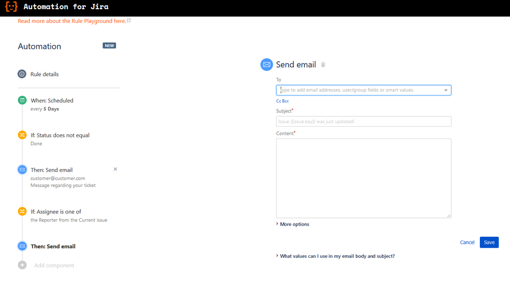

Hi @Manpreet Singh ,
have you tried an automation rule?
Here you find an extremely good webinar, in which you get to know automation, very practical examples and also a playground where to test them (without using your automation executions - if you have limitations): https://www.atlassian.com/webinars/software/getting-started-automation-jira
In this webinar you also get to know the rule playground (https://docs.automationforjira.com/rule-playground/) where you can set up and test automation rules without using your executions. Just because I was curious, I tried out to configure an automation responding to your requirements (you'd need to exchange some of the values, but I included the picture for a better understandign of what I try to imply ;-)
If you need further help let me know - I was fighting your find roughly two months ago, but am a happy man by now ;-)

Hi @Sebastian Mühleis
Thanks for the solution, it worked like a charm. I am able to achieve what I was looking for.
