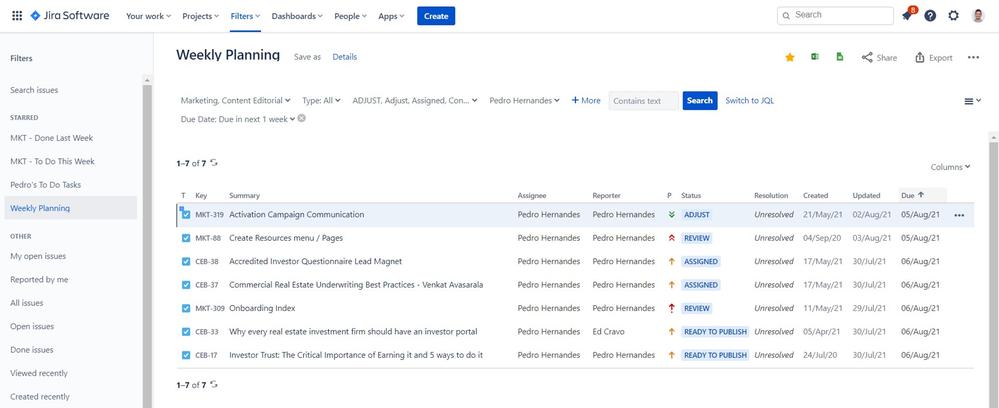

Hi, I just want to send the result to this filter result below (project in (MKT, CEB) AND status in (ADJUST, Assigned, "Content Value Feedback", Editing, "Final Review for Publishing", "IDEAS | BACKLOG", "In Progress", REVIEW, "Ready to publish", "To Be Assigned", "To Do") AND assignee in (5f0cec379d9a120029406004) AND due <= 7d ORDER BY due ASC, created DESC) in a Slack Channel Notification in a weekly basis. How to?

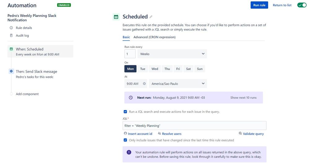

Yep, I have an individual subscription, and did try with the webhook, but it's not working:

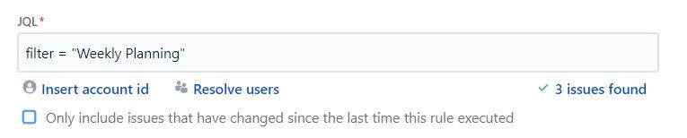

Alex Koxaras -Relational-
August 4, 2021
The rule you have created will run only for the issues that have changed since the last time that rule executed.
What I would do, for testing purposes, is to:
  • Change the trigger to manual
  • Remove the "only include issues that....", just to make sure that I will receive results
  • Run manually the rule
  • See if I receive any messages on slack
Click as well "validate query" to see if you are getting any results.
Let me know how this will go.
Bill Sheboy
August 4, 2021
Hi @Pedro Hernandes
Adding on to what Alex suggests and your automation rule image:
As implemented with the scheduled trigger with JQL, this will post a message for each issue found.  If you would prefer one message with the list of issues, consider using:
  • a scheduled trigger with no JQL
  • the LookupIssues action with your JQL
  • a condition to check if there are any issues to send {{lookupIssues.size|0}} is greater than 0
  • and then send the message with the list of issues

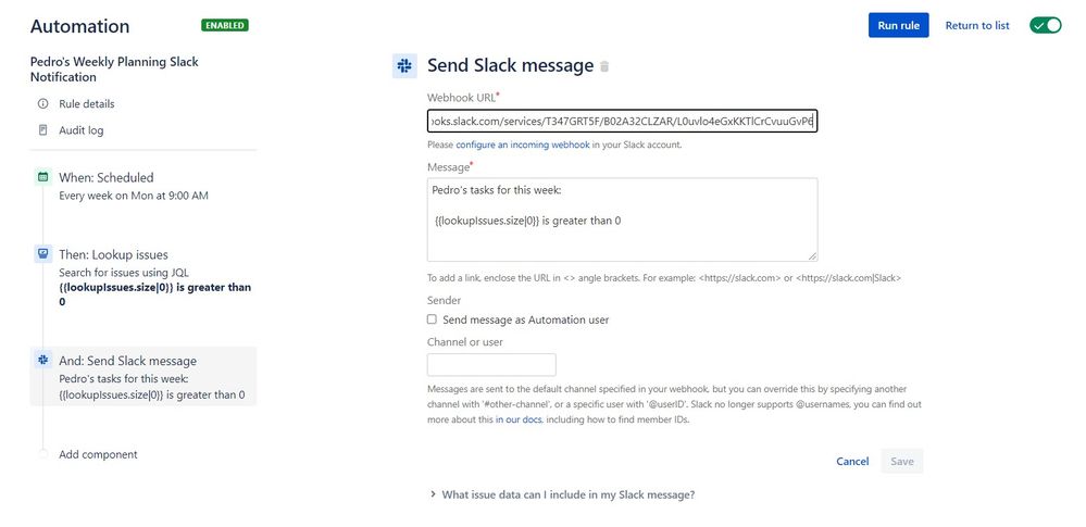

Pedro Hernandes
August 4, 2021
It validates, but doesn't send these 3:
@Bill Sheboy I add it, but it doesn't seem right (because it didn't work of course), where and how should I do this?

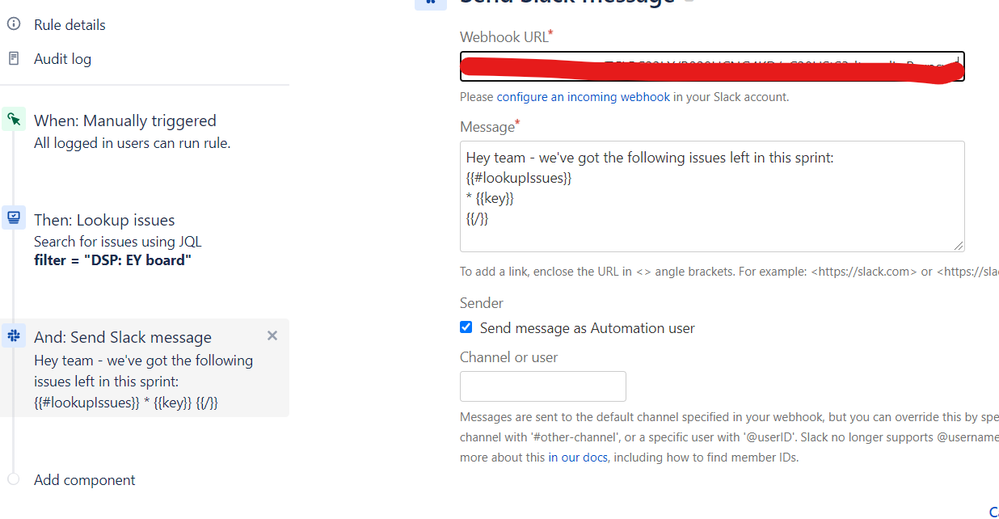

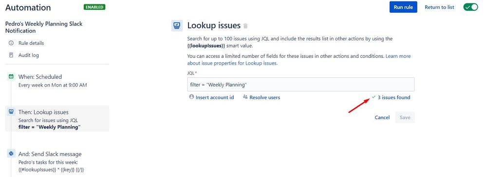

August 4, 2021
  • In the lookup component, use the filter= "weekly planning".
  • Add a advance condition, as @Bill Sheboy stated with {{lookupIssues.size|0}} is greater than 0
  • On the Send Slack component write something like:
Hey team - we've got the following issues left in this sprint:
{{#lookupIssues}}
* {{key}}
 Test the rule again

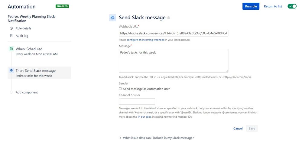

Pedro Hernandes
August 4, 2021
Am I missing something?

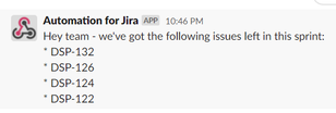

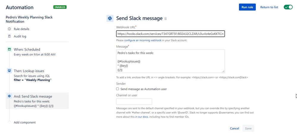

August 4, 2021
Hmmm...I'm getting correct results:
The only difference I see is that I have checked the box "send message as automation user". Try adding this and try again.
Bill Sheboy
August 4, 2021
Hi @Pedro Hernandes
If that does not fix it with the suggestion from @Alex Koxaras -Relational- please try this:
  • after the action for LookupIssues, add an action to write to the audit log with the number of issues returned:
Number of issues returned = {{lookupIssues.size|0}}
  • post an image of your audit log from trying to run the scheduled rule manually.  That may reveal what is happening; I suspect your filter is not running as expected.
Thanks!

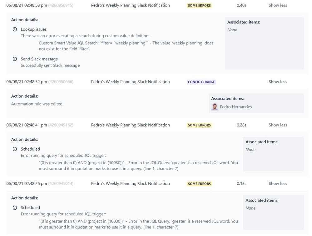

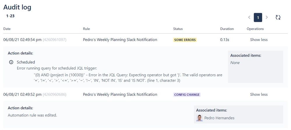

Pedro Hernandes
August 6, 2021
Nope, still blank, here are the logs:

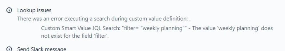

August 6, 2021
@Pedro Hernandes first of all, your JQL is wrong. You might have saved it with a different name. So carefully go back and check the correct name.
When you will enter the correct JQL, and you will click "validate query", it will return something (even 0 results).
Make that change and let me know
Alex
