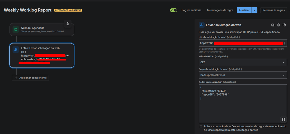

Is possible send project ID using trigger schedule for send in the weebhook?

I need send the project numeric ID and the project lead numeric ID to N8N for use in integration to send a message to slack.
But I have many projects, so i want create global automation.

Body request webhook to n8n:
"projectID": "{{issue.project.id}}",
"reportID": "5037998"

What I need is to receive the space ID in n8n on a weekly basis, because I will generate a report in n8n for each space.
However, this is not linked to any issue.
So I solved it by exporting all the spaces and inserting them into a Google Sheet, which will be queried by n8n.
