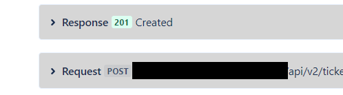

When I validate the rule with it set to 'POST', and sourcing a ticket that would trigger the flow, it works!

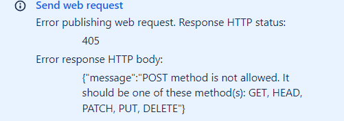

So then I go to trigger this workflow outside of the validation within the rule itself and I get the below error in the audit log:

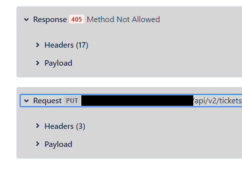

So then I go back in the workflow and update the action from POST to PUT based on this message and change no other settings. Then when I go to validate I get an error that PUT isn't allowed, but to me this is expected because the API really expects a POST.
