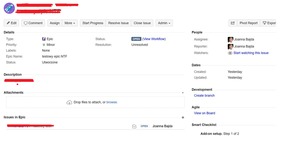

Hi,

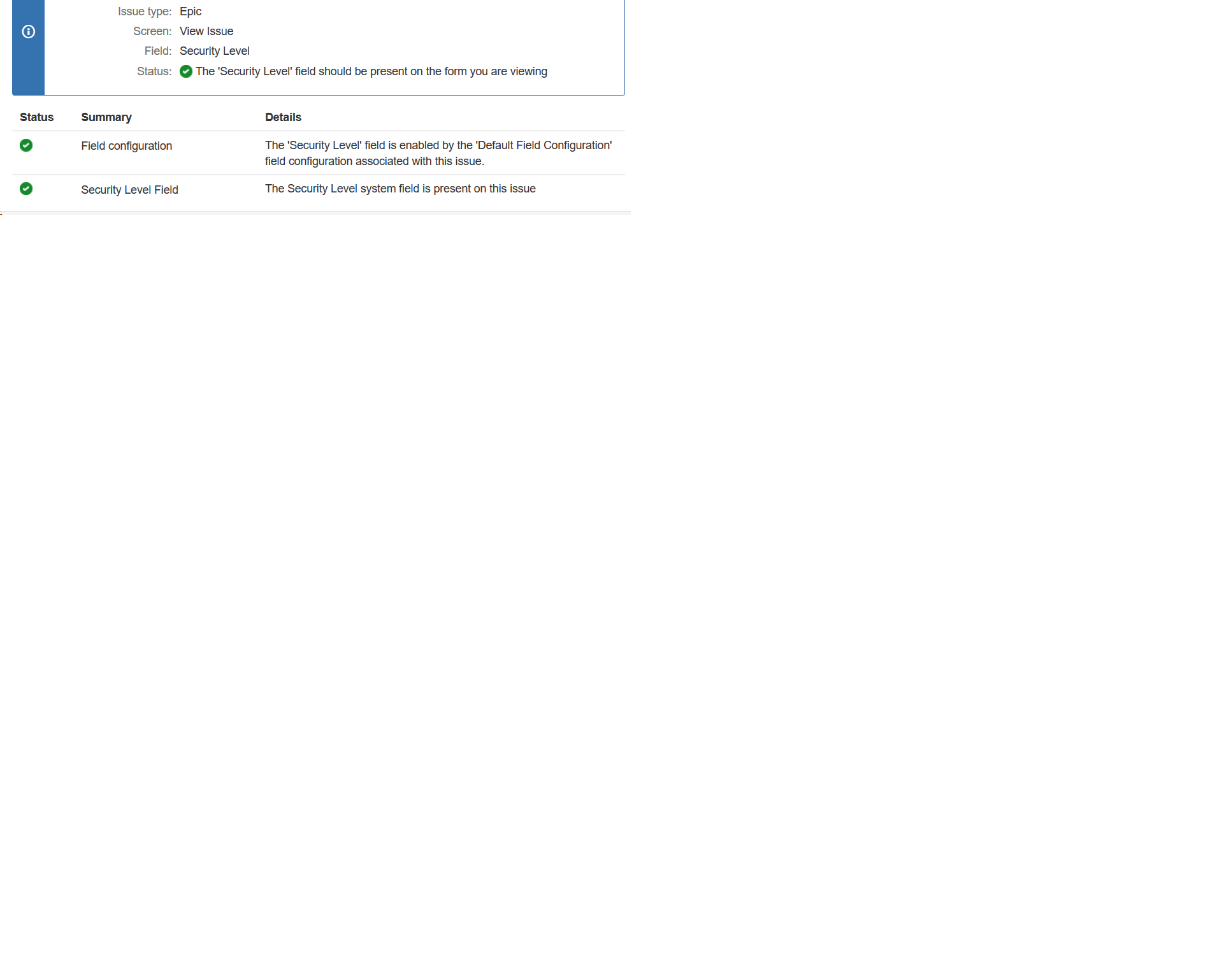

I'm testing security level schemes on our test jira envirement, I set up scheme, add security levels,  I have (as project administartor)  'Set Issue Security' permissions, field is added to the screens, When I'm checking "where is my field" tab it said that I should see it on the screen, although it's not there.

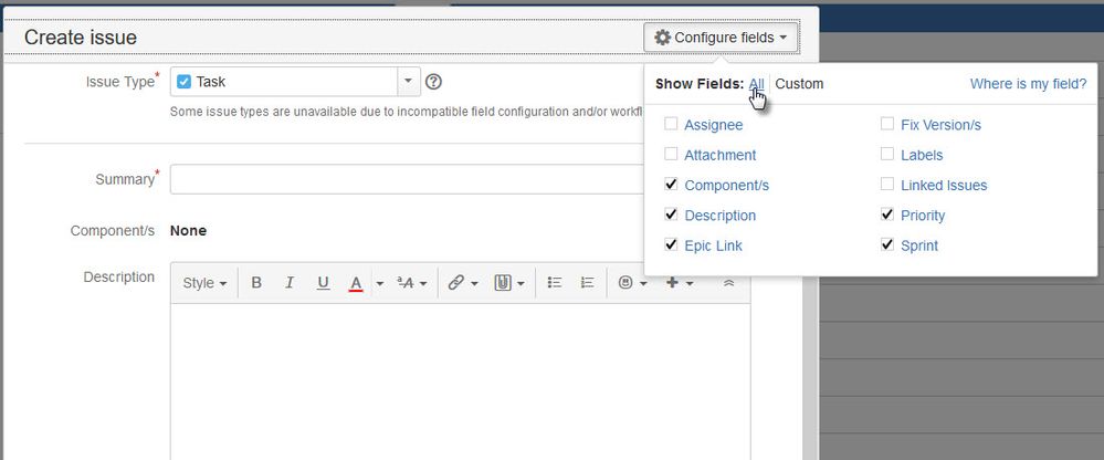

The only possibility I can think of at the moment is that it might be shown a custom selection of fields, instead of all fields set to be potentially displayed.
Can you try this from either the Create or Edit Screen?
Note that the View screen won't generally show a field unless it has a value set, with some exceptions, so you might need to set a Security Level before being able to see it in the detailed view of the issue.
Joanna Bajda
July 12, 2017
@Ignacio PulgarThanks a mill, so silly mistake I expected to see this field on view screene with value: none.

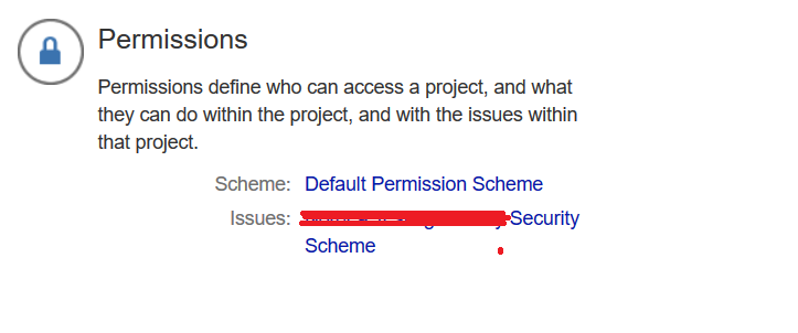

You don't mention if you have associated the scheme with the project?
Joanna Bajda
July 10, 2017
Yes I did associate the scheme with the project

Joanna Bajda
July 10, 2017
Well that's my problem here. You can see on the screen below there's no feeld at the screen even though I should see it. I spend couple of hours reading documentation and community pages, could not find anything...
