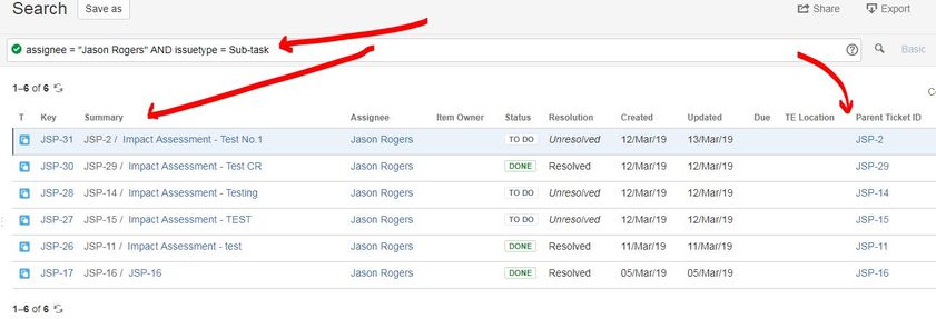

If you are just interested in just seeing what the parent issue-key is of a Sub-Task, then it will appear in the summary of the Sub-Task when you run a search. These will appear wheather the parent issue is assigned to you or not.
So your JQL would be sprint = X AND assignee = X AND issuetypoe = Sub-task (my example below doesnt have the sprint)
In my screenshot below I also have a custom field on the far right called 'Parent Ticket ID' but this was created using a paid plugin called Customfields++
Adam Clark April 15, 2019
Hi Jason - Thanks but this doesn't solve my problem. I actually need the parent Jira on a separate line so I can export the parent and sub tasks in a CSV
