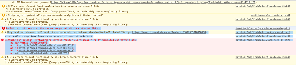

I see below error in javascript console of brwser

The diff in the console between that which works and that which doesn't, is the same console error as the original poster screenshot e.g. "Uncaught (in promise) SyntaxError: Invalid regular expression: /p[o/: Unterminated character class"
