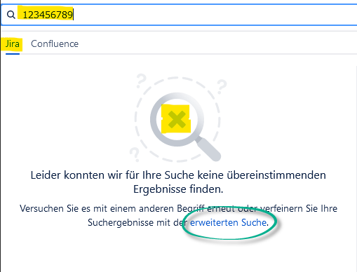

Hi there,

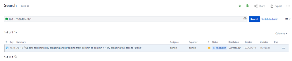

just try to use the advanced search as mentioned in your Screenshot. I have marked it for you with a green circle ...
After that you should see something like the advanced search in Jira where you are able to easily create your JQL.
Choose your field Seriennummer = "123.456.789" or Seriennummer ~ "123.456.789" and you should succeed.

fine, then you need to search something like this in advanced search ( JQL )
"serial number" = "12345789"

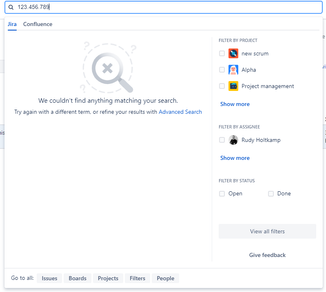

Hi @[deleted] ,
You should type in the search string and hit enter. then you will see the search results. Jira does not show a preview on searches on text fields (afaik).
Rudy

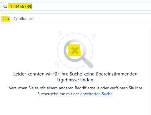

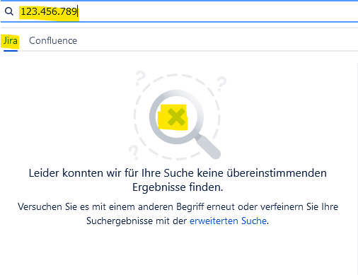

I hit the enter button and there still were no results :)

Strange, when I search I get:
And when I hit enter it gives me the search result:

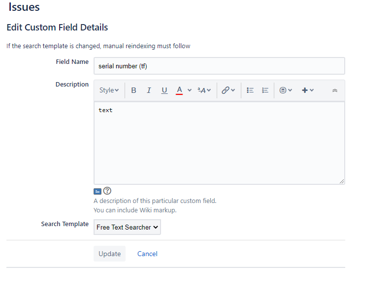

is it also a number field or a text field?
Based on the screen snap above your JQL Search in Jira should be:
"serial number (tf)" ~ 123.456.789
If this is a Text field try using ~ operator to compare this with part values.

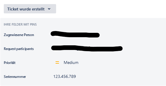

I presume the field = Seriennummer is an open string field rather than a pre-populated drop-down menu - if so - try this:
If the field = Seriennummer is a pre-populated drop-down list - you will need to use slightly different syntax - try this:
Seriennummer = 123.456.789
