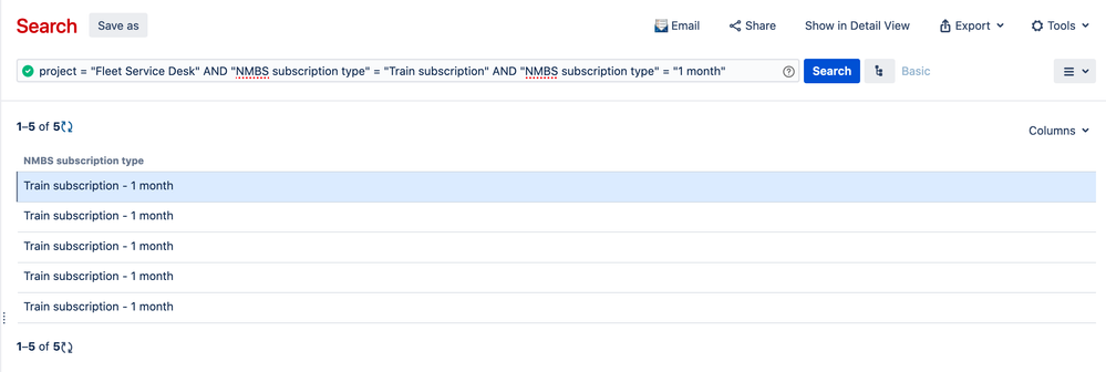

Basically what you can do is filter on the first part of the cascade separately from the second part. The first part would give the tickets with that value from the cascade, no matter the second part. The second part would give all issues that have that value in the second part of the cascade, no matter the first. So what you need to do, is ask the issues that have the first part AND the second part. This would look something like this:
(in my example, notice i query twice on the same field. first for the type, then on the subtype, and i get a list of those issues)
In your case this would look something like this:
"problem type" = hardware AND "problem type" = monitor
Hope this helps!
