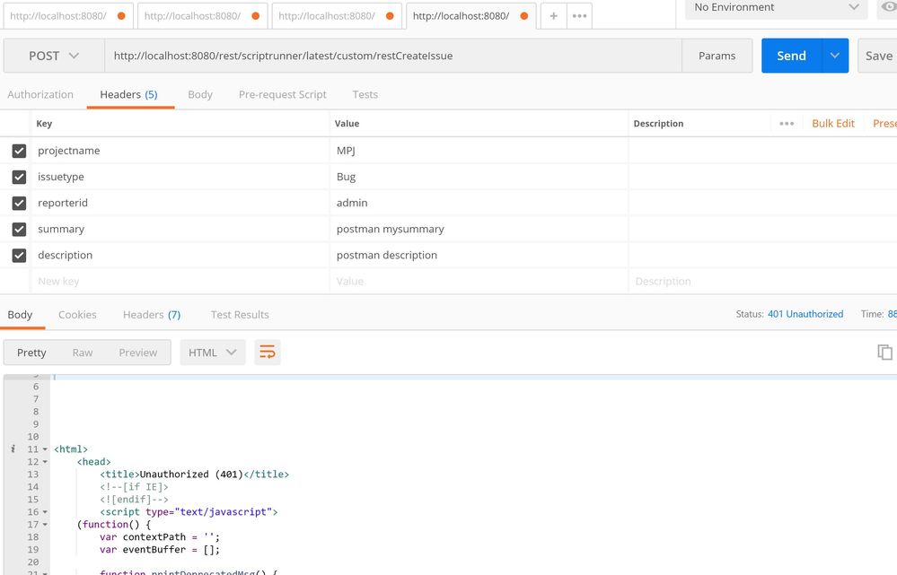

2.  I am trying make a post call using Postman tool like this:
But it is erroring out.

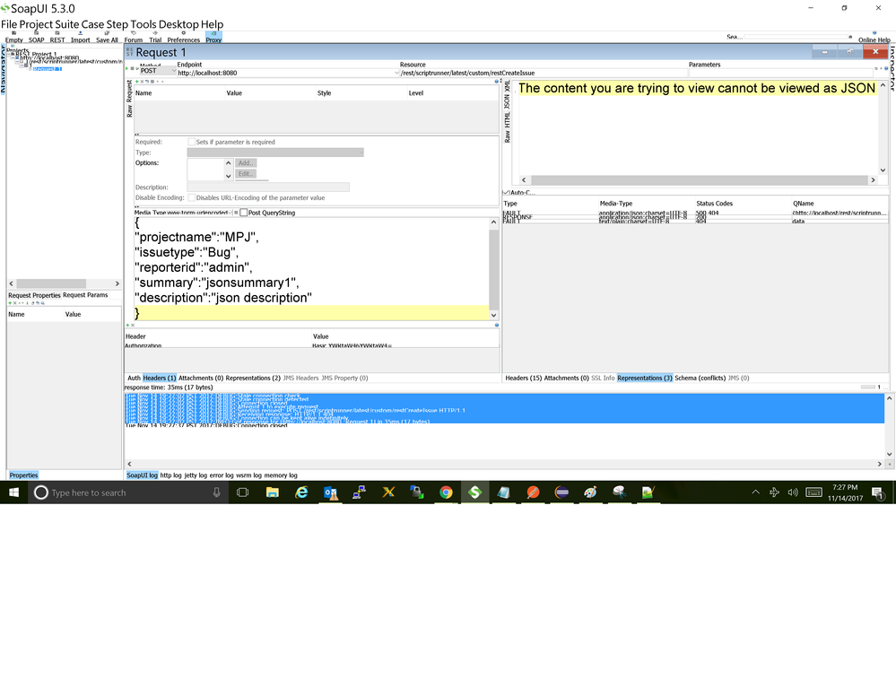

Creating JSON body:
"projectname":"MPJ",
"issuetype":"bug",
"reporterid":"admin",
"summary":"jsonsummary1",
"description":"json description"
and modifying read like:
import com.atlassian.jira.issue.fields.rest.json.beans.PriorityJsonBean;
import org.codehaus.jackson.map.ObjectMapper;
/* Reading from JSN Body, if request is JSON */
def mapper = new ObjectMapper()
def bean = mapper.readValue(body, PriorityJsonBean)
def projectName = bean.projectname
def issueTypeName = bean.issuetype
def reporterId = bean.reporterid
def issueSummary = bean.summary
def issueDesciption = bean.description
it is giving error:
[Static Issue Type Checking] No such property projectname for class com.atlassian.jira.issue.fields.rest.json.beans.PriorityJsonBean

2. You get unauthorized error. When you call your Rest function from the browser, you are authenticated by the same session as in the browser but in Postman you need to pass authentication parameter in the header. Search how you can modify the header in Postman and add to the header the following parameter:
Parameter name: Authorization
Parameter value: <authstring>
You get authstring the following way
convert "username:password" to Base64 then authstirng= "Basic " + "your converted "username:password". You can read more about basic authentication in Jira here:

3. You can query parameters from the JSON playload like this
add import groovy.json.JsonSlurper
then you would query projectname with the following line
def jsonSlurper = new JsonSlurper()
def object = jsonSlurper.parseText(body)
def projectname = ((Map) object).projectname

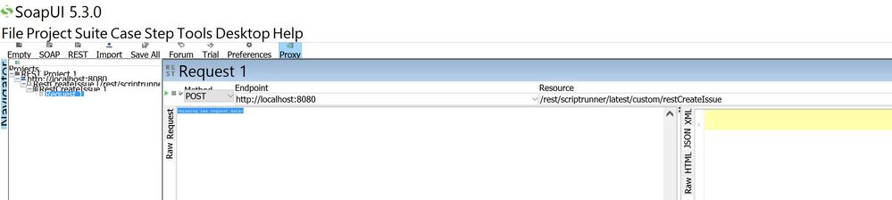

I use SoapUI to play with REST. if you install SOAP UI, I can help you with header settings

I have installed open source version of SoapUI. I will code as you suggested to red input and try first before I ask you..

I have installed opensource SoapUI, I will work on it and ask you question after that.
Thanks a lot for support.

Can you please give some pointers to headers..
Alexey Matveev
November 12, 2017
In Request 1 go to the header tab and put the parameter I was talking abou

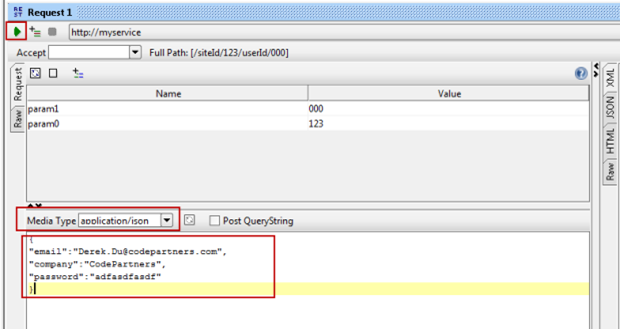

Alexey Matveev
November 12, 2017
kumar sam
November 14, 2017
Just to update I am able to make get request using parameters and Authorization parameter in soapui
I am trying to figure out how to post JSON payload...
Alexey Matveev
November 14, 2017

Hello Alexey
Appreciate all your support. I have tried multiple combinations before posting here..
I still am not able to get the json request to jira using soapui. As it is Jira version 7 remote api accepting is by default on...
Here is the screen shot:

kumar sam
November 14, 2017
used application/json as Media Type
Alexey Matveev
November 14, 2017
Hello,
There is a message on your screenshot "The content which you are trying to view can not be viewed as JSON". Choose there JSON tab.
I guess the error is 404. It means your rest call can not find  your REST endpoint. I had such problems with Scriptrunner. Try to create a new REST endpoint with the same code (change restCreateIssue to restCreateIssue1)
kumar sam
November 14, 2017
Tried that but still get 404 :-(
kumar sam
November 15, 2017
Ok Figured it out..
Changed first line to POST and it works.
A big thanks for your help Alexey.
