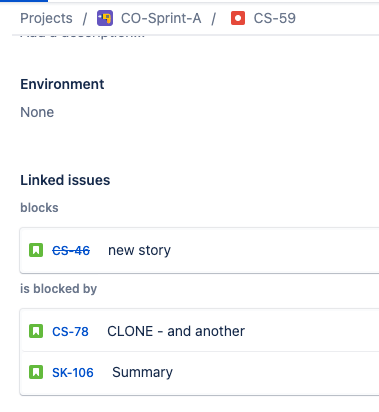

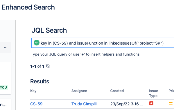

The function is working correctly for me.
Can you provide a screen image that shows the Linked Issues section for one or more of the "pr1" issues from your list, showing that it is linked to an issue in the "pr2" project?

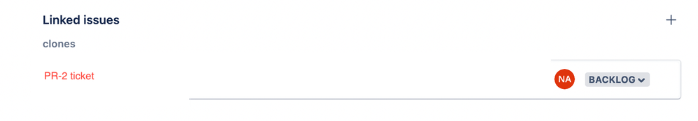

So in my example,
pr1-1 ticket has a link to pr2 project. The link in pr1-1 is shown below

I've done the same in my environment, and it is working.

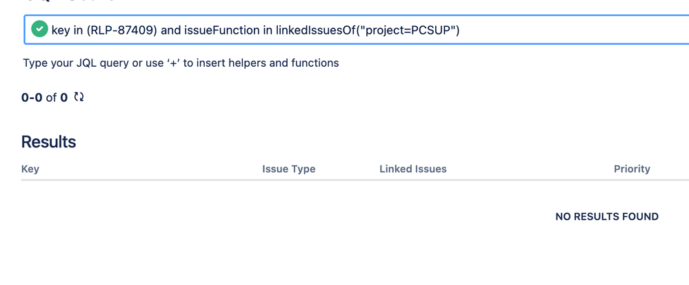

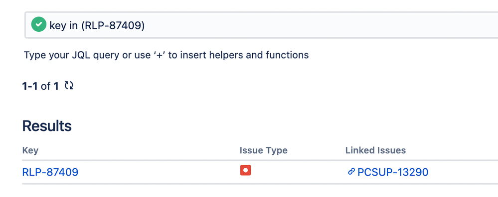

1. Here you can see RLP-87409 is linked to a PCSUP ticket

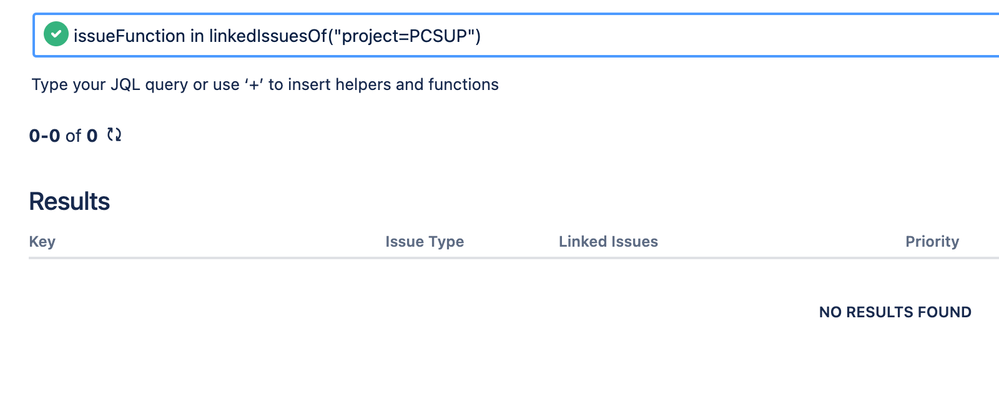

2. But when I run this query , I am supposed to see RLP-87409 in the results because it is linked to a PCSUP ticket but I get 0 results

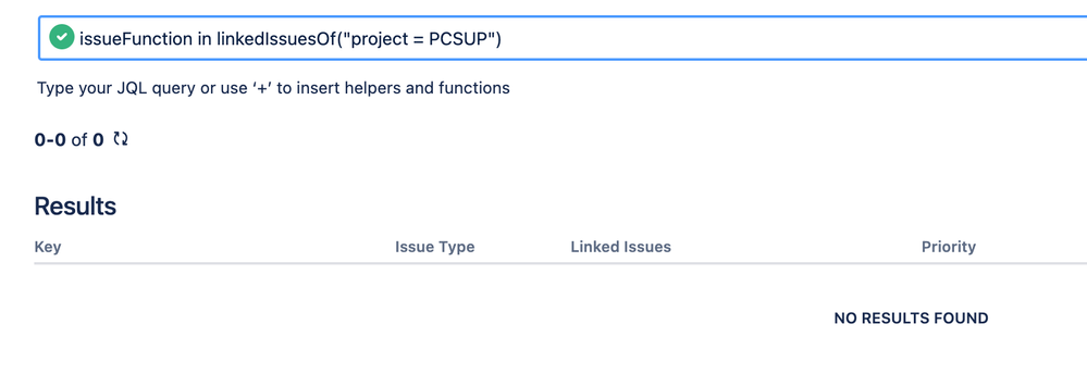

What if you remove the "key in" clause and have just the issueFunction clause? Does RLP-87409 appear in the results?
I removed "key in" and get nothing
I also tried issueFunction in linkedIssuesOf("project = PCSUP")
with and without space between project and PCSUP
Should I add anything else in the subquery to get data ?

Is just one type of link used or multiple types of links? I see in your first image that the "pr-1" issue has a "clones" link to the "pr-2" issue. Is Clones the only link type used between the issues you expect to see in the results?
I have tried to recreate this with the Clones link using issues in two Company Managed projects, and in two Team Managed projects, and have not been able to recreate the issue.

Here is something that I found (these are real project values)
If I run this search, I get results
project = RLP and issueFunction in linkedIssuesOf("project = PCSUP and status != done")
But If I run
project = RLP and issueFunction in linkedIssuesOf("project = PCSUP") , I get no results
So, I need to add an "and" clause inside linkedIssuesOf to get any result, but, I dont want to put any clause other than project inside "LinkedOfIssues"
