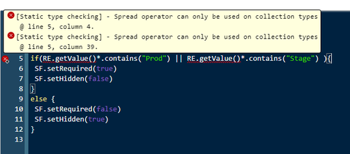

Hi @Italo Qualisoni [e-Core] , thank you, this what I see now on line 5.Snag_6f0c98b.png
If I use the below script, even if I select non prod this script makes the other field required.
def RE = getFieldById("customfield_14200")
def SF = getFieldById("customfield_14217")
def RE1 = RE.value.toString()
if(RE1.contains("Prod") || RE1.contains("Stage") ){
SF.setRequired(true)
SF.setHidden(false)
else {
SF.setRequired(false)
SF.setHidden(true)
