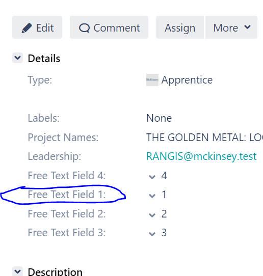

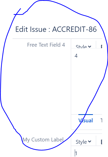

The problem I am having is that the behavior is executing when I create a new jira issue and when I edit the issue but not when I view the issue.
Any assistance is greatly appreciated.

Hi @Tomas Arguinzones Yahoo ,
Unfortunately behaviours do not work on View Issue screens, as mentioned here. You can find workarounds on this topic as well.
Antoine

Hi @Antoine Berry  Thank you for your assistance. Yup, I just confirmed that with scriptrunner tech support as well (I was hoping the documentation was not up to date :- )

On create, the behavior executes:
On edit, the behavior executes:
